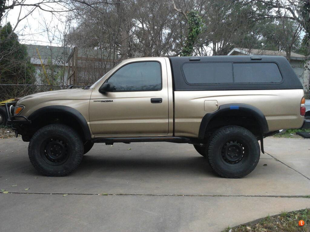

    I used a top that was on a ford ranger. The angle up front would probably match an extended cab Tacoma but my truck is a reg cab. It was a cheap shell so I bought it. I measured the gap between the bottom of the shell and laid out a scribe line to match the profile of my truck cab. I sliced the corners off the shell and notched a recess for the 3rd brake light, then laid down fiberglass mesh and cloth. Sanded smooth and rolled with struck bed coating. Now it fits good and looks good enough for me. I ran it on my truck for a month or so but decided to sell it since I moved to a new place an don't have room to store it when not in use. It took a few evenings to get all the fiberglassing and painting done, but its very easy to do. vyta8ybu_a246c1a91e4a31fd93204517aae2a80ce0203668.jpg

    That is a fantastic job on refitting a top....We used to have to do quite a bit of fiberglass work to our kart racing bodies but it didn't turn out that well.

    Thanks. If I cared I could have spent more time getting it to fit a little better but it worked out fine. My main goal was to make it waterproof and it is. I really didn't spend much time on sanding, really just scuffed and roll the coating on with a foam roller.
