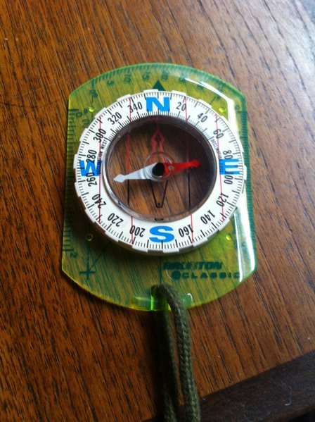

    I have a question for those who use a compass during their trip. I have a Brunton Classic and I realize that that it's the white arrow that is giving me the North... after comparing with other compass it seems that it's supposed to be the red one... Am I wrong? It is a defect of my compass? But even if the white arrow is suppose to give the North, the reference arrow inside that is giving the True North when I get my bearing is red... so it is kinda confusing....
    Thanks for any output!

    Should have been the red end, yes its standard. Sounds odd, yours.

    Your compass looks to be new, if so take it back to where you bought it for an exchange. Or if its' not so new, Google Brunton customer service about a replacement.
    While you could probably use as is with some mental gymnastics on your part, you would be better off having one that was correctly colored.

    Looks to me like it's pointing West.... :stirthepot:

    Not very new... I got it when I was in the boy scout but never used it and new that I found it back a few years ago i started to be more interested about it.
    Your idea is good I will make a few search to see if I can get it replaced. Thanks

    So I just wrote to Brunto and the guy a the service told me that my compass has been exposed to a strong magnetic field and that cuase the needle to reverse polarity... Dunno where it happens...:notsure:
    The best part is that they are sending me a new vial free of charges that I can swap from my baseplate!
    I am very happy with the ending :p
    Thanks to @INBONESTRYKER who gave me the tip about contacting the customer service. I don't know why, I never think about that as an option I have...
