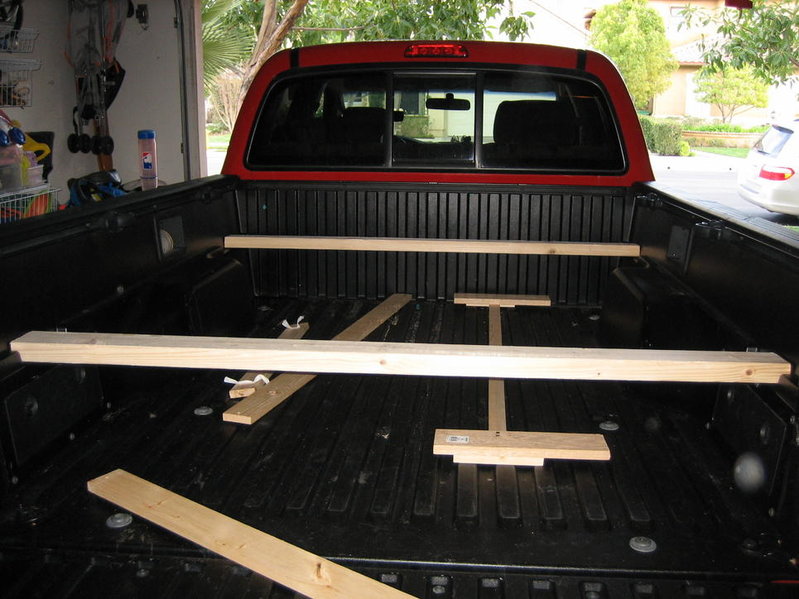

    Ok, it may be a little early for camping, but I was inspired when I saw this in the free section of craigslist:
    http://www.ikea.com/us/en/catalog/products/00098761
    Measurements look pretty close to my longbed size.
    Trimmed it down a little because it was a little longer than the bed.
    Cut it in half for easy storage and setup.
    Cut some wood for a custom fitting.
    Has a nice incline feature that allows you to get back to stored stuff below.
    Drive in movie ready.
    Now, I need to get a truck bed tent, then I am set.

    Plenty of storage underneath and breaks apart nicely.
    That is a Coleman full size air mattress in case anyone was wondering.
    Seems pretty easy to make (minus the incline) even if you don't have the pre-made frame.

    Was it the correct width? The length thing sounds easy, but I am wondering if you could show us more on the way you mounted it. Looks fun. rob

    what keeps it from tipping forward or backward?

    How is that stand supported on the tailgate end of the bed?
    Nevermind the dumb ?, i see now.

    ok, i think some more pix will answer some of the questions.
    pic 1 2x4's across
    pic 2 use notch for 2x4 57" (if i remember right) was the perfect length.
    pic 3 1x4 with another piece to fit into the rest of the notch still left empty.
    extra piece also used as a spacer to push plank beyond the small side rail thing.
    the width of the bed was a little short, so this extra piece will provide support.
    the center of the 1x4 is held up by the wheel well.
    pic 4 this how it fits. has to be snug.
    pic 5 you can see how half the frame sits on the side rails.
