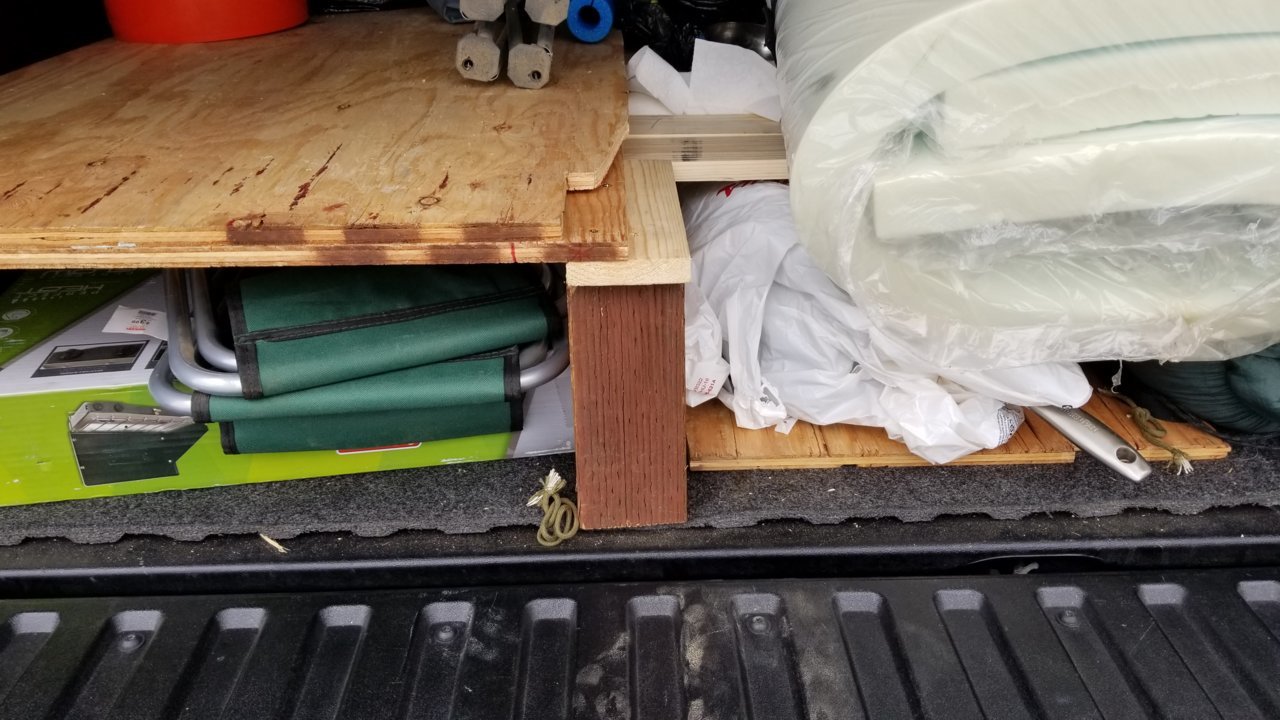

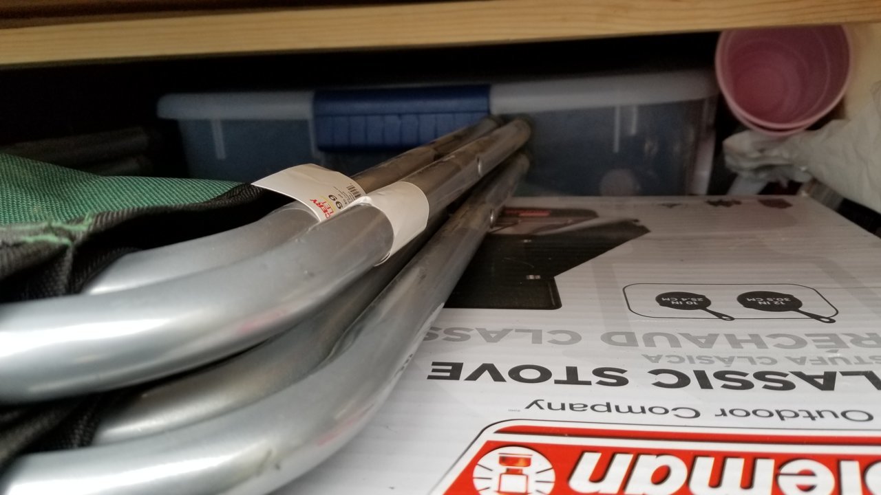

    I built a platform in the bed. I have a campershell. I used 2 1x4's on front wheel well for cross braces and 2 more on the back. I used a 2 short 4x4 pieces in the middle of the cross braces for vertical support. I then got a sheet of plywood and ripped it in half after I got the width cut. That way I could easily break everything down.
    For padding, I use 4 of the interlocking padded floor pieces. They look like square puzzle pieces and made of soft rubber.
    The mattress pad is one that I got cut to size from an upholstery shop. It's memory foam.
    I bought under bed plastic storage bins with wheels to use as storage underneath the bed platform.
    It was fairly simple to make. It's fully functional. I even used a scrap piece of the plywood and cut it to fit on the tailgate to make a counter. I made cutouts on the sides for the tailgate tension cables to keep the board in place.
    I will post pics later. Just got back from camping this past weekend.
