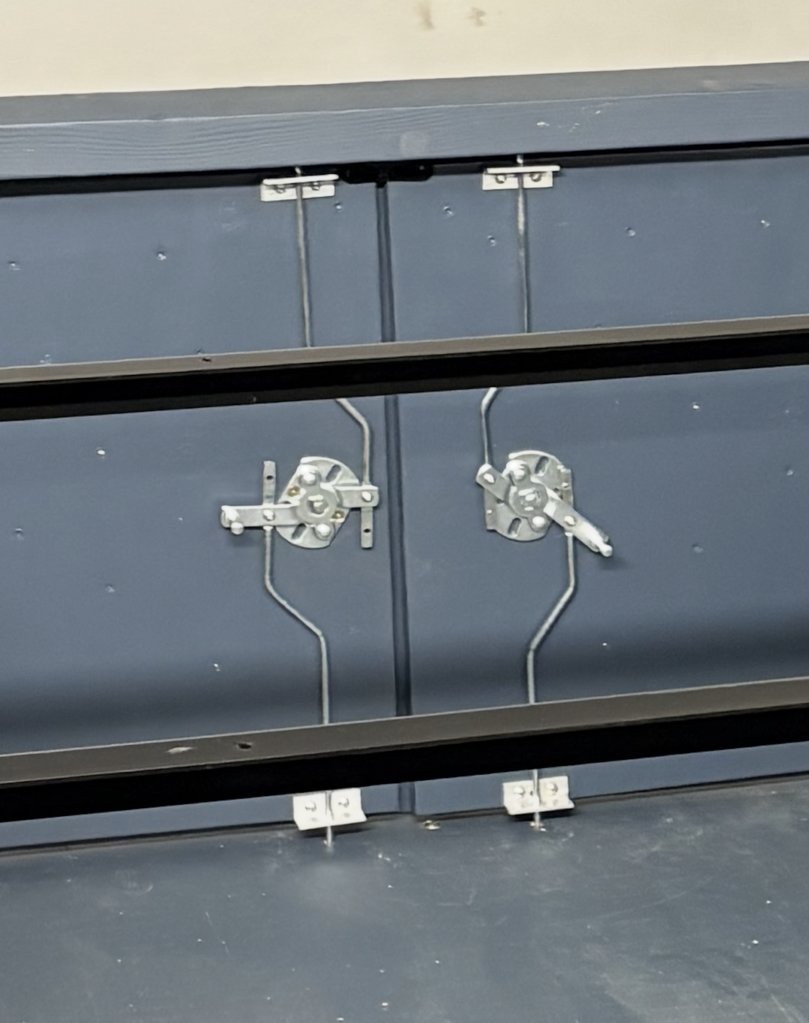

    Got handles on the doors and custom (custom sounds way cooler than DIY) rod-locks on the inside.

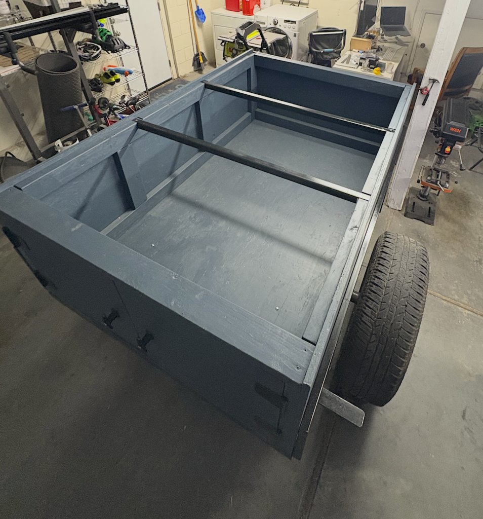

    Here is a look from the inside, with the roof of the box off. :
    Basically the two "swivels" drive the rods up into the roof and down into the floor. They T-handles I used on the outside are "handed" but the swivel locks are not, hence the funny angles.
    I used some screen-door turnbuckle reinforcing rod:
    https://www.homedepot.com/p/Wright-...le-for-Screen-Door-Zinc-Plated-V691/202065835
    and some swivel locks:
    https://shop.hillmangroup.com/ccrz__ProductDetails?sku=853164&cclcl=en_US
    and regular truck cap T handles (left right pairs).

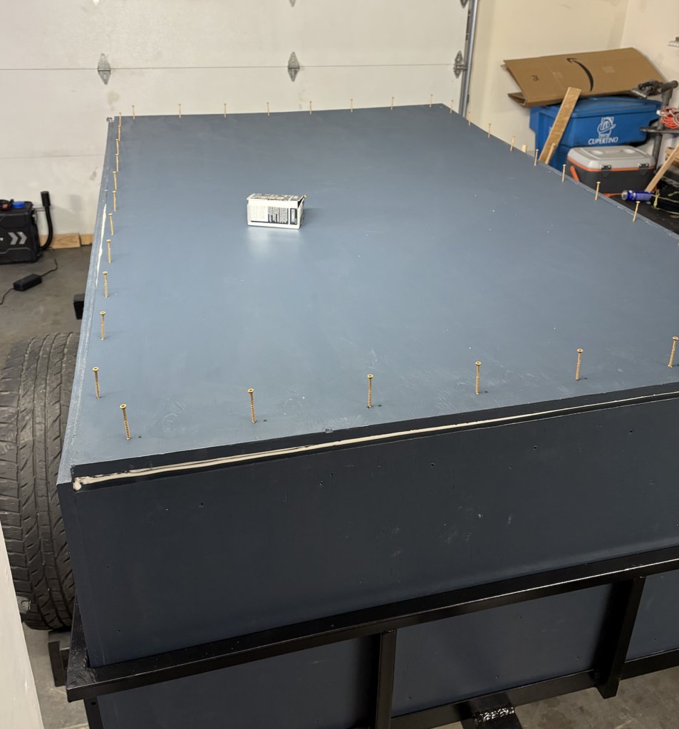

    Next up was the roof, with lots of construction gun-glue:
    Unfortunately I wound up with a lap such that the sides were exposed. The trailer was a touch over 48" wide on the inside, so I needed put put the floor/roof "between" the side walls.
    I plan to add edging to cover it up, but it isn't ideal either structurally or for waterproofing :shrug:
    (Yep, that's a diesel heater in the background. Another sort-of-DIY project, attempting to make it quieter and a little more compact.)
