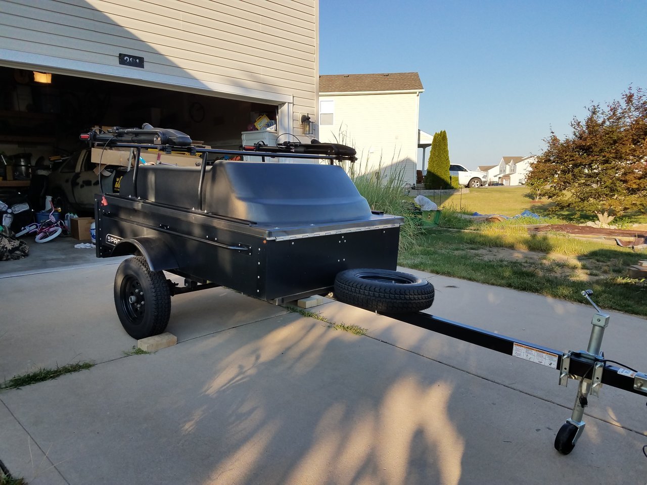

    Yes also throwing in a couple of nice bike racks. Looking forward to all the possibilities this opens up!

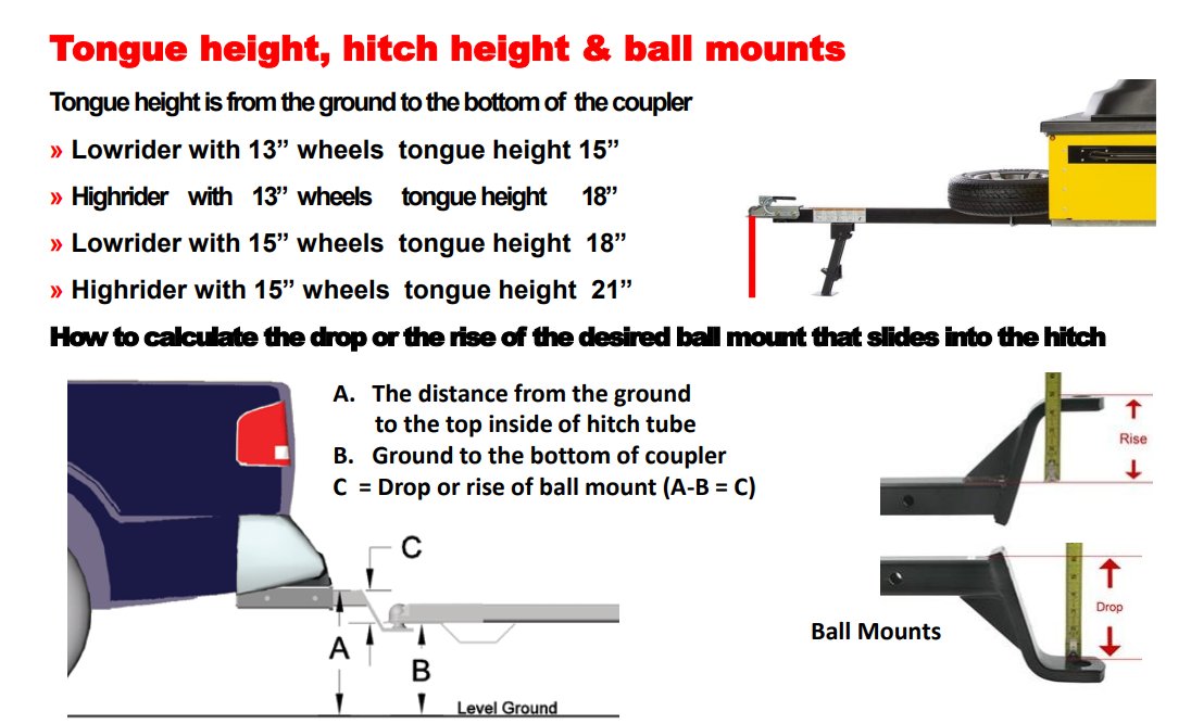

    Make sure the seller confirms the size of the ball required. A trailer this size should be a 2" or 1 7/8" ball.
    Also this page will be helpful to make sure you have the correct drop or rise for the ball mount so the trailer rides level:

    OK cool. I just heard back from him he said that the tire size is 13's.

    A 4" drop might suit the situation better going off the chart the MFG has.

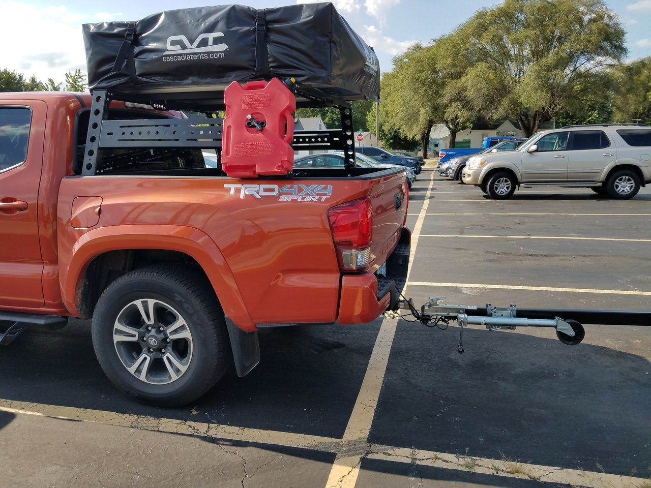

    They only had a 3 1/4 drop. I got that but it looks so low to the ground! I get the trailer in about 30 min or so ...guess we will see

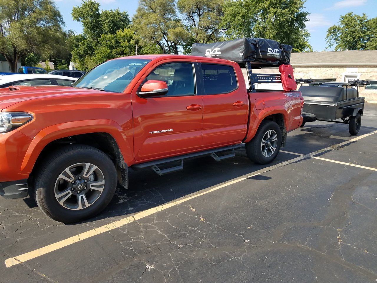

    It looks like the trailer is riding pretty level? :thumbsup:

    Its a bit lower than I would like. I think im going to see if I can swap out the hitch for a 2" drop and see how that does. Overall the trailer is fantastic so far. I helped a friend move yesterday and we packed it solid! Taco pulled it like a champ... now my backing up with it that is a different story! I need lots more practice..

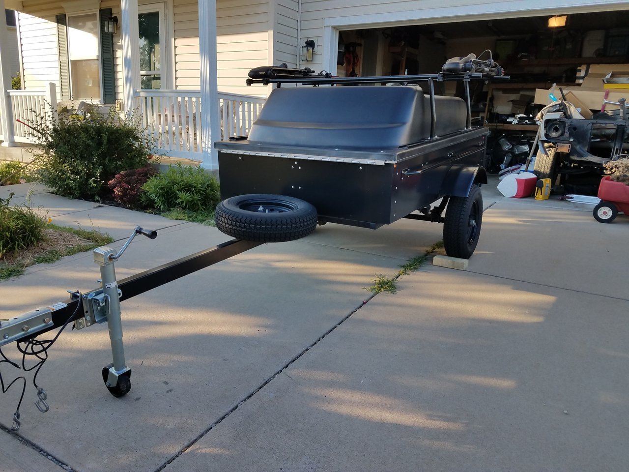

    looks like a cool trailer! i've never seen that model before, sounds like you got a good deal!

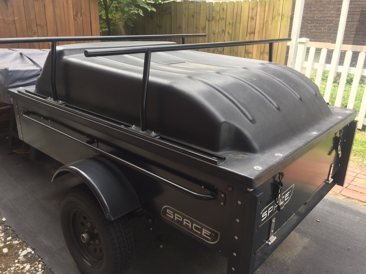

    Thanks me either but right before I bought it I did a ton of research on them. They are pretty darn good trailers as far as I can tell. I want to beef it up some and make it a bit more sturdy. The wheels are much smaller than I would like 13" and the axel and springs are seriously light. I am also still trying to figure out how I want to build this rack. I'm hoping to go in the direction of This style. [​IMG]

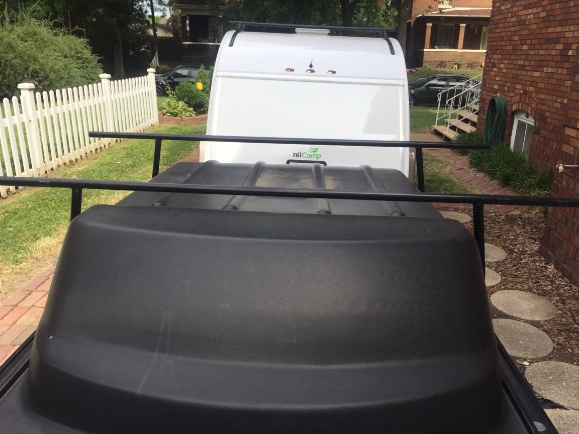

    Also.. Does anyone know what box this is? [​IMG]
