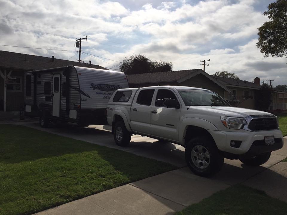

    Well it sounds like you need a Keystone Springdale Mini. 17 ft 3200 lbs I believe and will match your truck. :)
    It has a shower and little bath. Bluetooth stereo, fridge stove place for tv and a queen size bed.
    Mine 2017

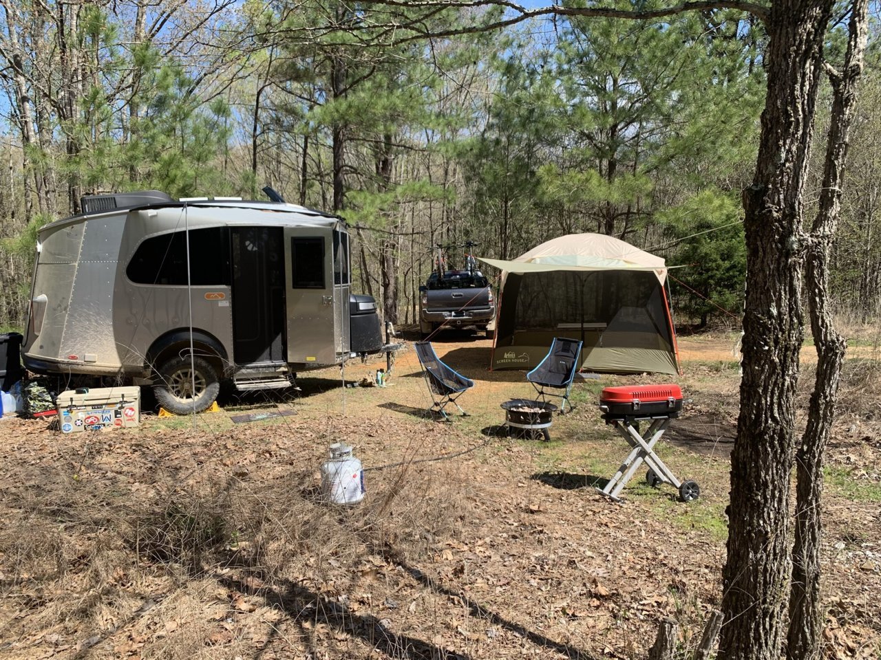

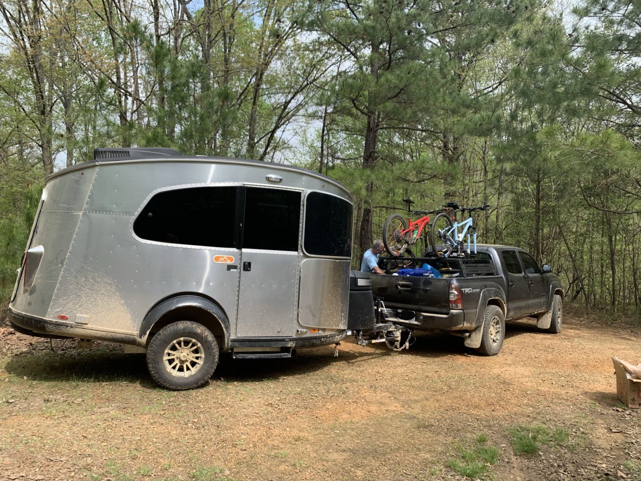

    I would consider an airstream basecamp x. We are new to the camping world but love our basecamp. Pricey yes but it can really get around. It is lifted and has a great departure angle. I have an equalizer 6k hitch and it pulls like a dream. I would rec pulling only in fourth. Trans pan temps climb quickly in 5th with any hills. It has a wet bath and a pass thru for the shower, it has a combined black and gray water tank and when boondocking you become acutely aware of every flush! Don’t forget the peripherals you may need; screen house, generators, grill, fire pit etc... it is amazing to have the ability to go when you want and camp where you want anytime. 4376022A-1FDA-4018-82F2-DCC94B9DBCDF.jpg1AC1A81C-39BD-4D9A-948A-2642E2AC4B16.jpg
