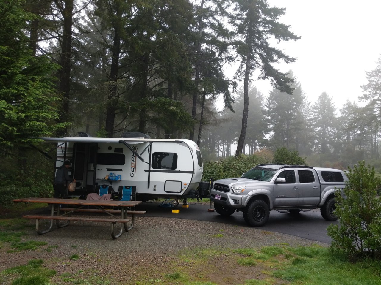

    Have you looked into the GeoPro?
    crackils and Micbt25 like this.

    2015 Tacoma Sport
    3" Procomp lift, 33" BFG's, TRD exhaust, and cold air intake.
    Yeah man we love it. We have the 19FBS. It's a little over #3000. I did upgrade the suspension and put air bags on my truck just to help it out. We pulled it from Albuquerque to Oregon last September.
