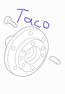

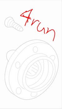

    I'm keeping ABS for basically the same reason. I completely understand it would be cheaper and less of a headache to delete it. I've determined that a machine shop is the way to go for pressing. It'll be more expensive but I don't want to destroy a bearing. I still need to source a set of spindles or buy the Hub assembly that my locking hubs mount to. They are $184 a piece from Conicelli so I'm leaning towards finding a set of manual hub spindles to get the part. Haven't seen any on Ebay as of yet.

    So every other part is identical on the spindle from my 4Runner but this hub assembly so the locking hub can mount in. Easiest way to get it will be buying a set of manual hub spindles from a Tacoma off ebay like you said.

    I'm confused.
    I had to go back and re read a previous post.
    Whatever you are pulling off the 4runner spindle/hub will work on the tacoma.
    If the 4runner spindles don't have ABS. Press out the hub on the 4 runner spindle.
    Press out the hub on the tacoma spindle. (the bearings will most likely break each time).
    Take the 4 runner manual hub and press it into the tacoma spindle with new bearing.
    #44

    BartMaster1234
    Aug 21, 2016
    #195197
    45,887
    Tyler
    Pittsburgh, Pennsylvania
    Flux Capacitor
    He’s going to use Manual Hubs, which the 4Runner never had.

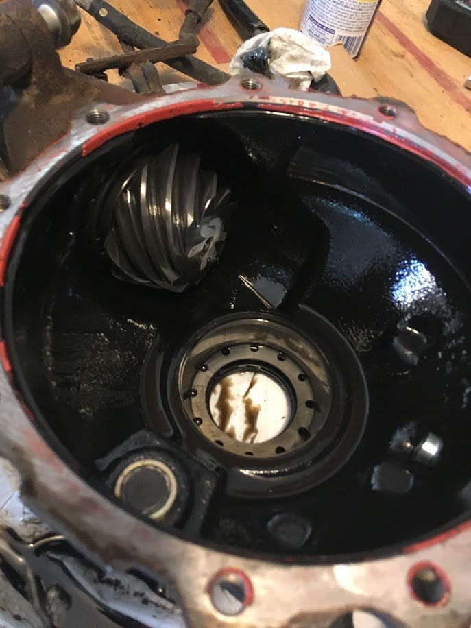

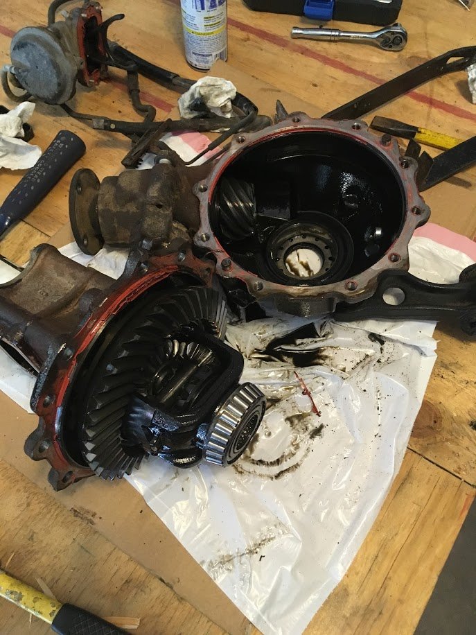

    #210143
    4,903
    Andrew
    2004 DC Tacoma SR5 4WD V6

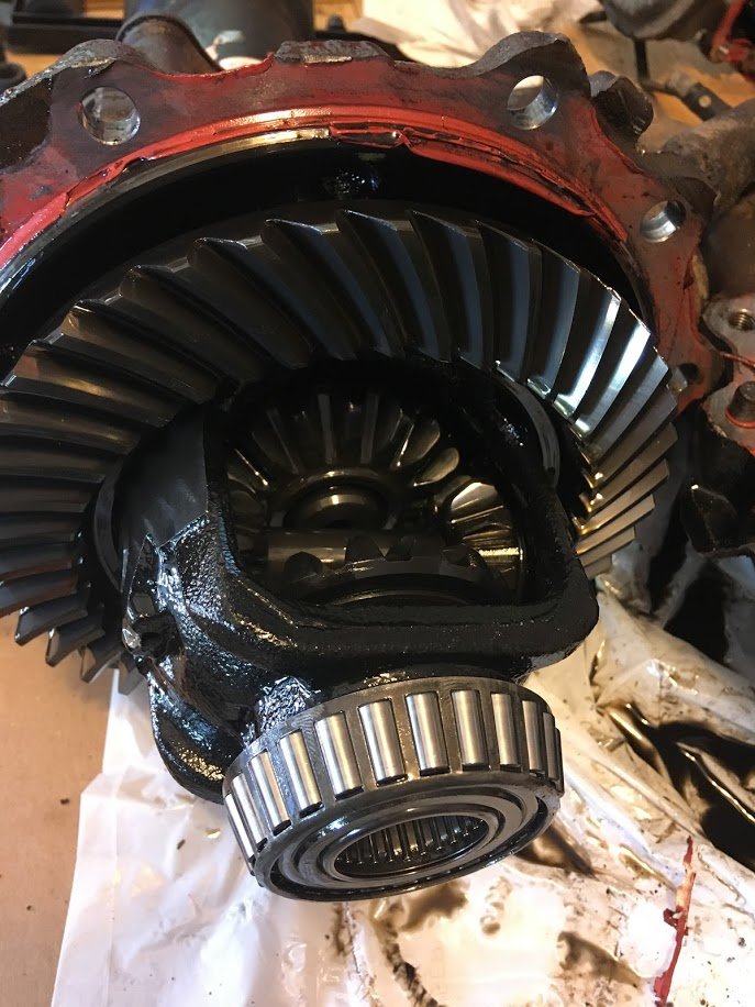

    T2uF2FviGUumMrq4DM8cUyNZ0-qnG7QZ61tk_c8J_f1bbfdfd2238b1632206aa8f6b011552b8350ff2.jpgxP11DK31r5nLYxLw0i3i0ySBKq-hmmGx3lD-yGp3_28e627b102a179341982820a8c2db815f6f82ada.jpgm4o6oOkRznji32DiyvP48kvjBNEsmkvAQFKoqc5b_8bc91cce26e6987b300c53444f8e3cae32aeda8e.jpgDiff is 100% confirmed 4:10. It seems to be in great shape from my limited knowledge especially for the condition of the rest of the vehicle it came off of. I'm going to replace all the seals and redo the gasket. Then hit it with a sand blaster and paint it red. Transfer case is next. Need to figure out what I want to lock the fork in place with too.

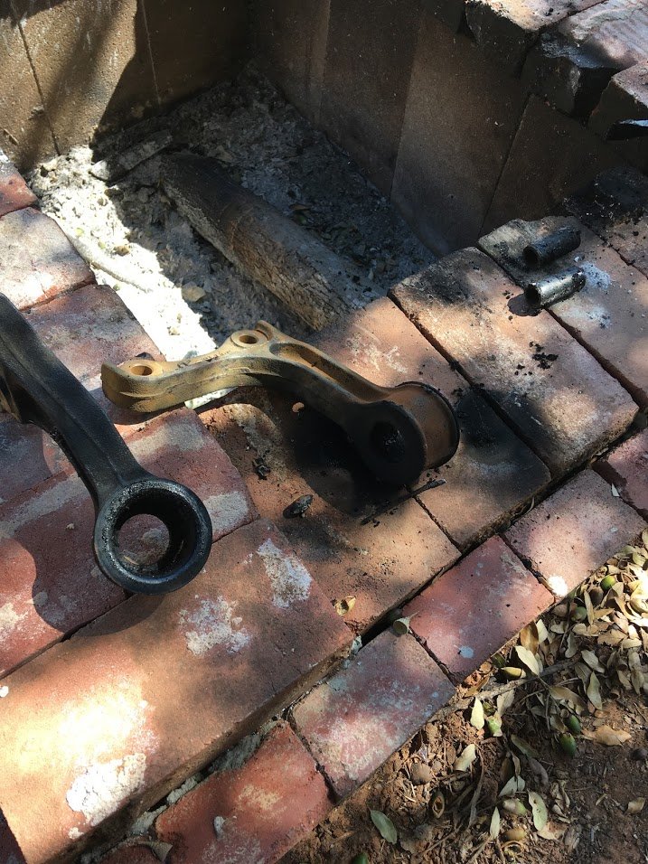

    Had Friday off from class and practice. Torched the old bushings out of my front diff mounts. I'll be putting some new bushings in that @Plastics Guy designed since Toyota doesn't sell new ones.
    I'm sandblasting/painting the arms and some other hardware and call it a day since I have an 8K race tomorrow morning. If I can get every item prepared and ready to go the conversion could go down in mid November. Otherwise I'll start after final exams.

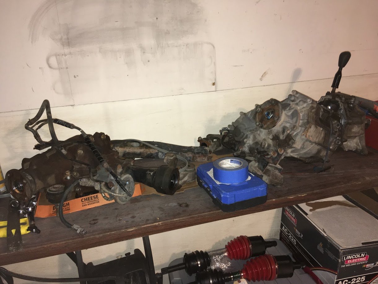

    Spent a few hours sand blasting and prepping things for paint. Differential is painted and I did axle shafts/pinion seals. Still need to figure out how I want to lock the actuator in place since I didn't buy a manual tube.
    But I guess the option is still there with part #41320-35030 @$142
    Transfer case is next for painting today and the front driveshaft needs to be cleaned up. After that everything is 100% ready for installation besides the transmission output shaft swap and front half of the rear driveshaft.
    I might just put my truck out of service for a week or two and ride my bike to classes. Didn't expect to get all this done during the semester.
