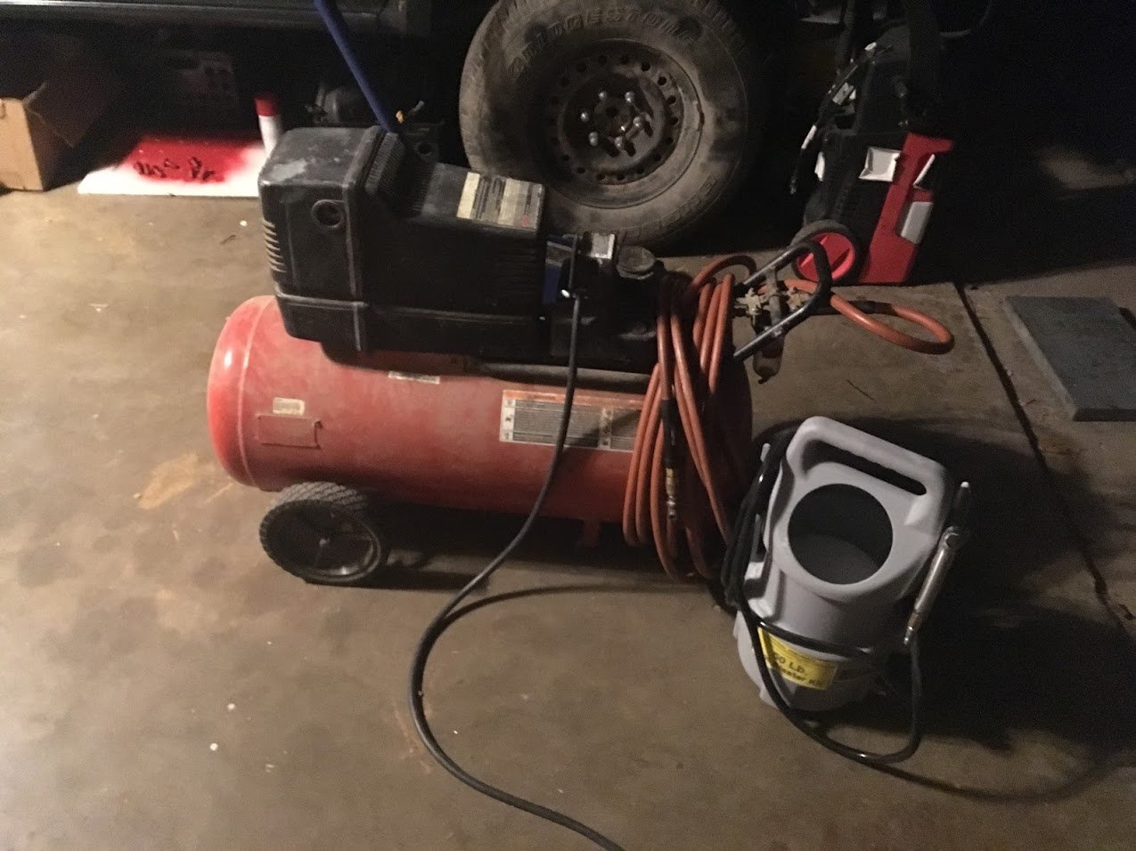

    Post some pics of your sandblaster setup.

    TmlRCMu69f4NI2tmGERRu7bV6NeCagnurGnCpr-P_f289009110aa4b385c2592b789ad1103fa574f24.jpg
    I just put this up on the workbench and hang an LED lamp to supplement the low light output of the lamp inside.
    If I'm blasting anything larger I hang some tarps next to the garage and use this thing. Nothing fancy.

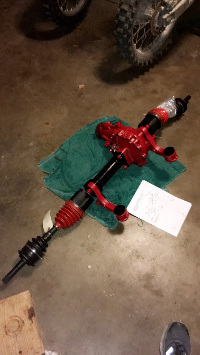

    12020B38-9263-454A-B1B8-D460E23EACB2.jpg My buddy picked this up for me in Austin for $50. 1998 Tacoma manual tubed 4:10. @BartMaster1234
    This diff saw a lot more off-road use than my 4Runner diff. I’ll be using it for parts to convert to manual tube. Then just hold onto it as a spare.

  7. Oct 26, 2018 at 10:45 AM
    #67
    BartMaster1234
    Aug 21, 2016
    #195197
    45,887
    Tyler
    Pittsburgh, Pennsylvania
    Flux Capacitor
    Crazy good deal. I paid $175 for my manual tube only.

    Did the axle seals. Swapped a better bearing in the manual tube side. The guy sold me that manual diff for $60 because instead of doing the bearings he just bought another front diff. I had Toyota FIPG black and decided to grab the orange/red instead. I know aftermarket FIPG is basically no different to OEM but I decided to just get the stuff from the dealer.
    Differential is sealed as well as the axle tube. Mounting arms are bolted on and I torqued everything to spec. Working on transfer case right now.

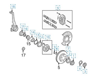

    @BartMaster1234 So those two parts (#15)4351535010 and (#17)9056052001 are an ABS rotor and a spacer? Between my ADD 4Runner hubs and my Prerunner hubs I should have whatever piece is needed or I have another order to make. I have every other part lined up on my workbench but those.

    I honestly have no idea. I just bought complete manual hub steering knuckles for my truck already and sold the old 2WD ones.

    https://youtu.be/dDivFqFQCus?t=287 Found a video fitting my situation. So it sounds like I can just purchase the ABS rotor and be good to go.

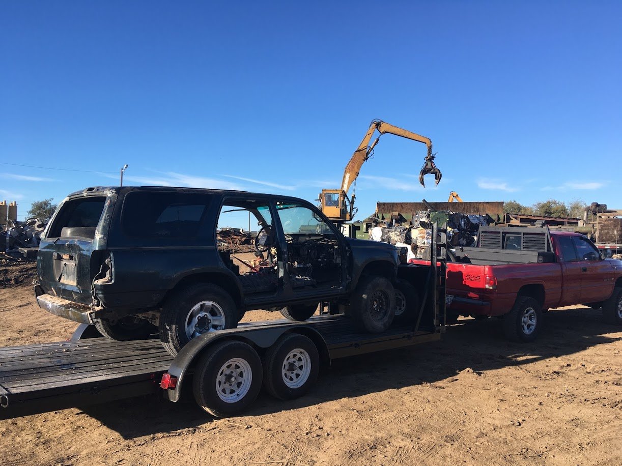

    The 4Runner died today. I got everything of value out of it almost. Only major things I wish I could've taken were the windshield and steering wheel. Originally I was told this yard wouldn't crush the car immediately and needed a steering wheel and wheels to move it around. Well I had time for a front loader to pick it up and let me take the lugs off the wheels. No time to find a torx bit and get that mint condition leather steering wheel. I'm in the process of listing the remaining parts for sale.
    Oddly enough there was a green 1998 5 speed 4x4 parked in town with NM plates in similar shape to mine. I've been trying to get in contact with the owner of it as it had been abandon for months. On our way to crush my 4Runner it was still sitting in the same lot it had been since May. On the way back the it had vanished. San Angelo is two 4x4 4Runners less now.
