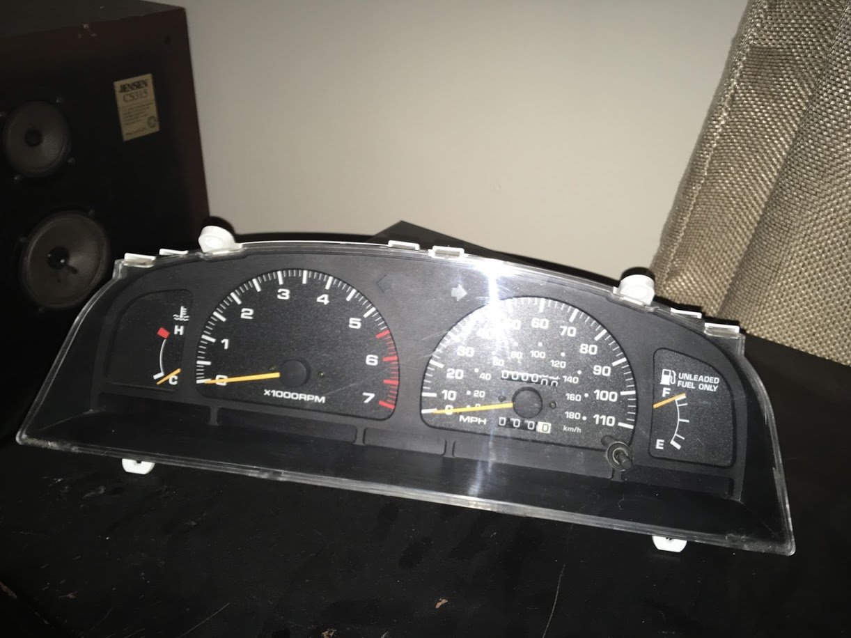

    Nah I loaded both to be scrapped. I stripped it down pretty good before that. I've sold the starter and alternator and have had some interest in the throttle body. Listing the part out locally resulted in a bunch of people thinking it was a running and driving vehicle which is really annoying.
    Unrelated but I also rolled back the odometer and listed it on ebay.
