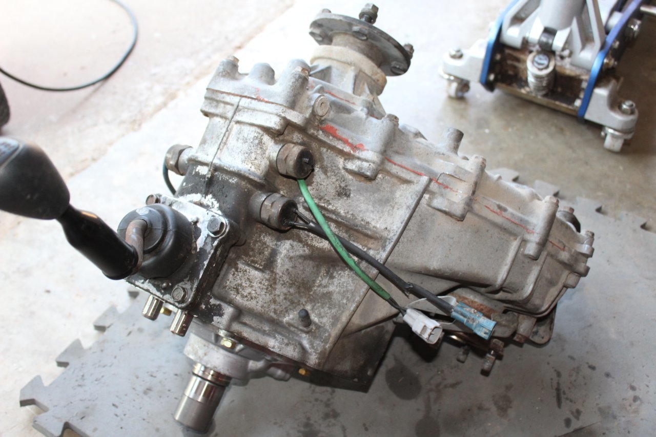

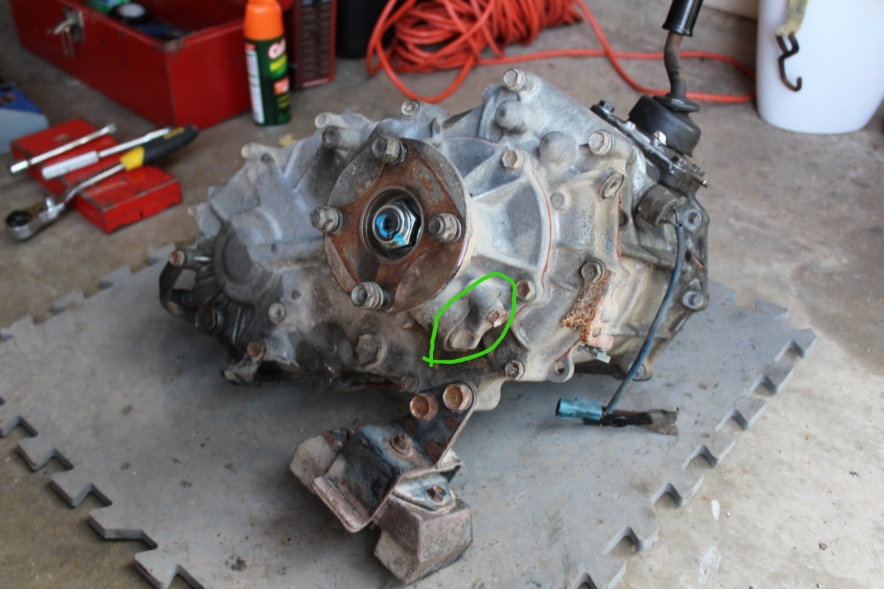

    @ToyRyd04 I know you're SAS already and everything but I had a question about my tcase. I'm using a j-shift off a 96 4Runner. Can I just unplug this hole and plug in a marlin crawler electrical speed sensor plug? Or are more steps involved? @BartMaster1234 So I broke one of my connections off way back when I pulled the tcase. I'm not 100% what each plug does. I plan on trying to wire into one of my extra dash light spots eventually.

    Don’t worry about it. That’s a transfer case position sensor.

    Yes, that is just a cover and you can put the vss in there. There are two styles, mechanical and electrical. On Marlin's site, the cheaper of the adapters screws onto an installed mechanical vss to convert to an electrical signal. (Running this since the 4wd swap, still no issues today). The other more expensive option is to buy the electrical vss that will bolt right in.

    I got lucky enough to find a speed sensor that fits from my parts guy. The one on the output shaft is your VSS and all the ones on top are the transfer case position sensors, which I just left unplugged since I’m going to manual hubs as well

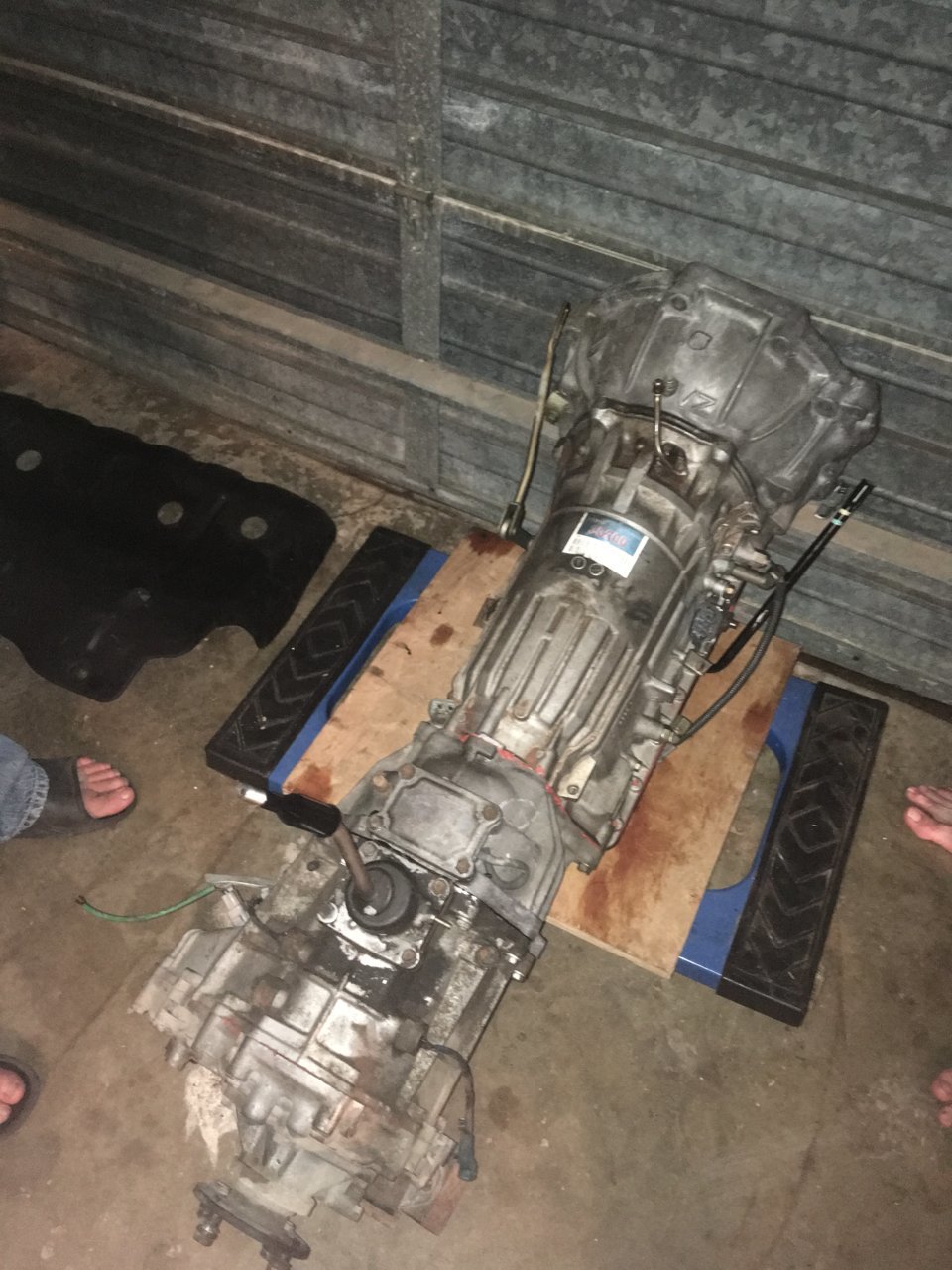

    A340F Conversion. That’s the output shaft donor chilling on the cart.
