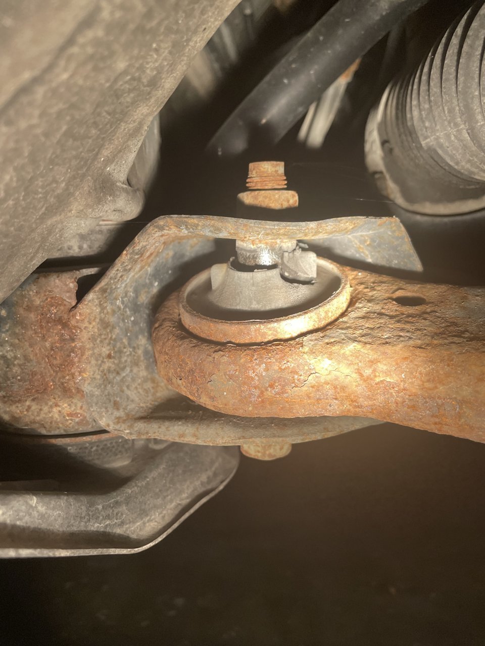

    LCA bushing on daughters Camry is toast. We just got it, and she can’t drive til December and I was looking into why it pulls to one side when the brakes are first applied. Can a bad bushing cause brake pull symptoms like that?

    Yep a bad bushing like that will cause the LCA to shift within the slop of the bushing. That changes toe on that tire when braking.
    Looks like you got a steering rack leak there as well.

    2005
