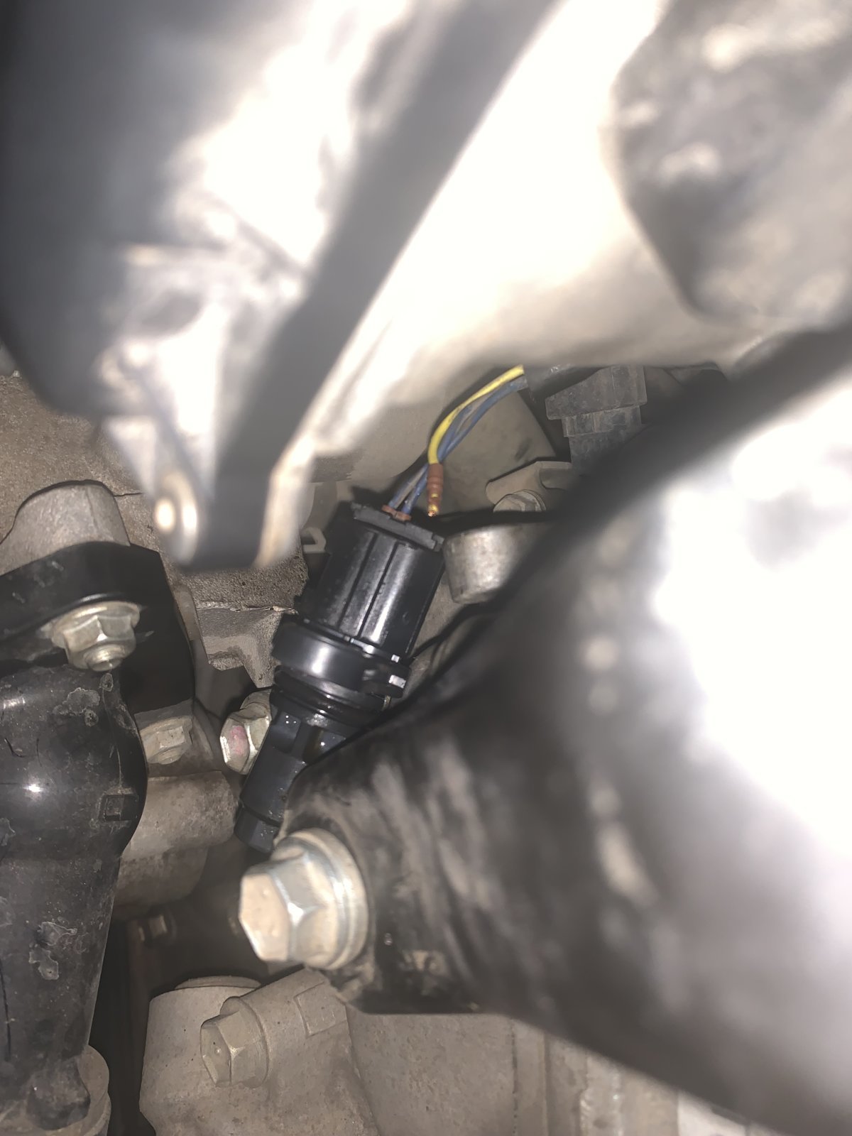

    I was replacing the camshaft sensor and a wire from the three wires on the connector is detached
    Is there a video someone can send me on how to replace the connector on 2nd gen Tacoma
    Any tips will help

    When you say detached, is the wire itself broken or did a pin push out of the connector. Sometimes you can just push it back in, make sure it’s in secure and isn’t just going to pop back out.

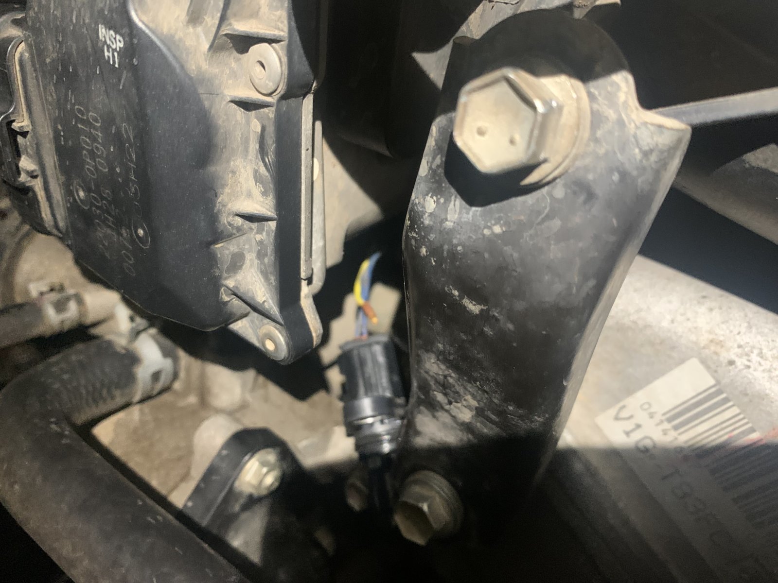

    This is how it looks. would this be a pin?

    Can you take a picture with the connector in better focus?

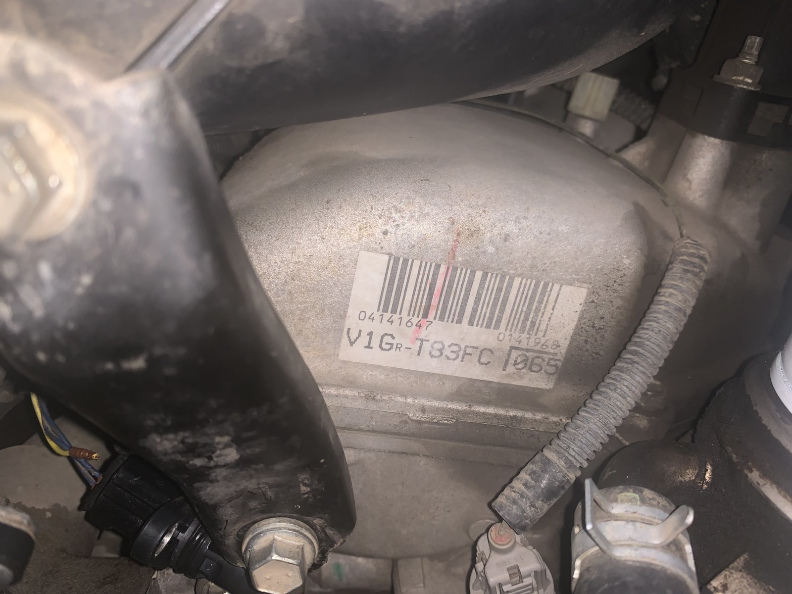

    If you tell me what engine, I can get you the connector, and the wire terminal #.

    Engine number

    Looks like rodent damage

    Looks like the copper thread is cut from the connector on the yellow wire. Not sure tho would that be a pin?

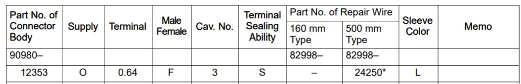

    The Terminal # is 82998-2450
    The connector is 90980-12353 (you don't need it if you depin current connector.)
    One of these should be all you need.

    The brown part is what helps keep water & dust out. At the end of the yellow part, you can see the gold colored inner strands. The pin broke off the wire.

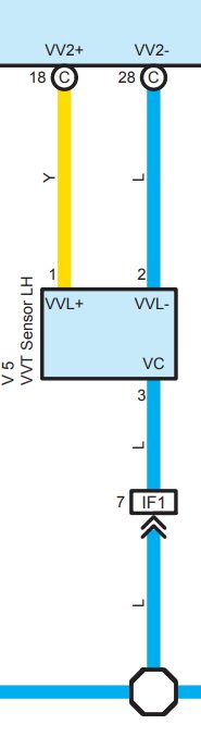

    Yes it does, if it isn't pinned correctly the sensor won't work and you could kill the sensor.

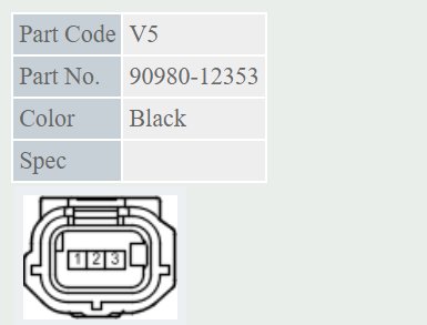

    The numbers should be stamped into the connector, @TnShooter posted the pinout above.
    There's 2 Blue wires but IIRC only one will have 5v with the key on and that one goes to Pin 3, the Blue wire that doesn't have 5v goes to Pin 2.

    Turn the key on, then test the blue wires with a voltage meter.
    Red probe on meter to blue wire, black to battery negative.
    The one that has 5v goes to pin 3. :thumbsup:
