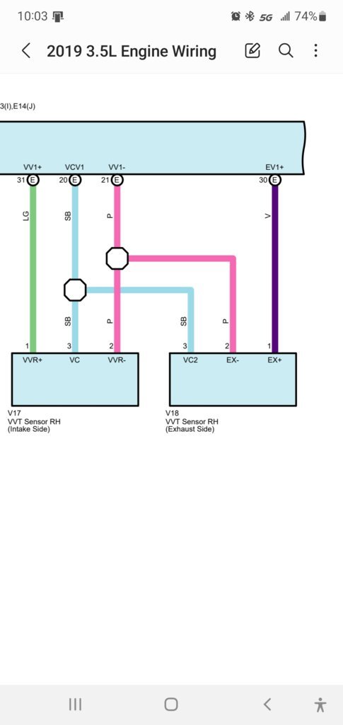

    Hey everyone I’m desperately needing some help with the correct wiring diagram to the camshaft pos sensor. Wires were cut, replaced connector, but still seems off. Feels like there’s no power when accelerating and crappy gas mileage. As of right now I have the wires for VVT bank 2 exhaust side as (1)purple(2)pink(3)blue.
    Any input would be greatly appreciated. Thanks!

    Looks like that's correct, what code(s) is it setting?

    Looking INTO the connector is the wire positions.

    Check engine light is no longer on. But something feels off… 7.8 MPG. Could the relearn be effecting the performance? Replaced sensor already and got the connector at O’Rileys and can’t see the number placement on the inside.
    By the way thanks for the replies guys.

    No something is off there unless your running a big lift and big tires that's really low MPG.
    What were the events leading up to the low mpg and cam sensor connector getting damaged?
