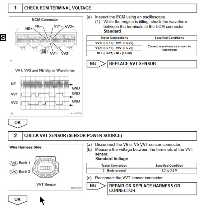

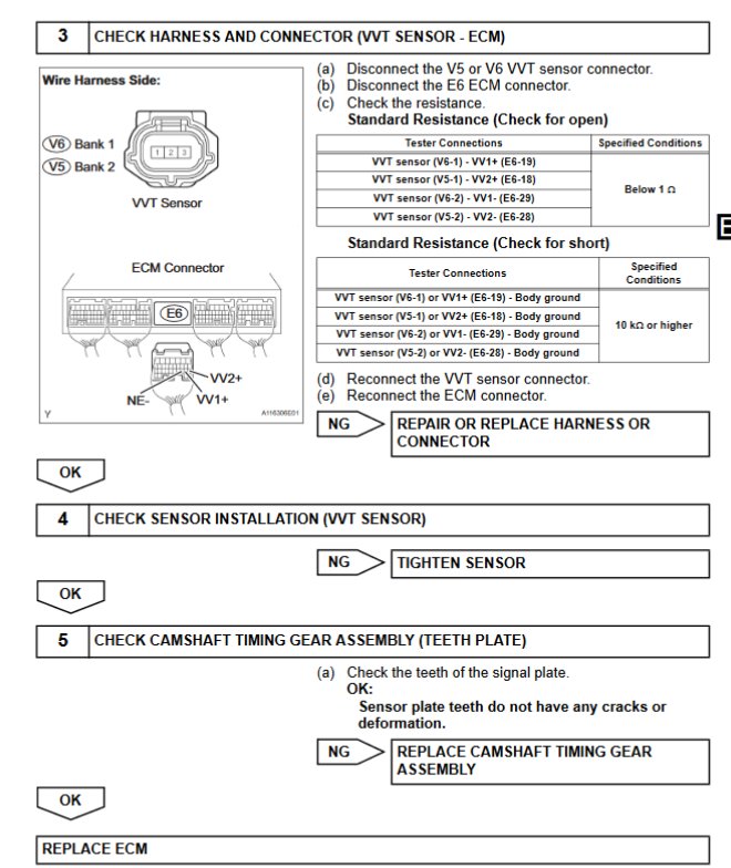

    As stated above you will need an o-scope to properly check the signals going to the ECM, But you can verify the wiring is intact and sound with a meter, see below.
    P0340 - Camshaft Position Sensor "A" Circuit (Bank 1 or Single Sensor)
    •Input voltage to ECM remains 0.3 V or less, or 4.7 V or higher for more than 5 seconds, when 2 or more seconds have elapsed after turning ignition switch ON (2 trip detection logic)
    •No VVT sensor signal to ECM during cranking (1 trip detection logic)
    P0343 - Camshaft Position Sensor "A" Circuit High Input (Bank 1 or Single Sensor)
    Output voltage of VVT sensor 4.7 V or more for 5 seconds (1 trip detection logic)
    Trouble Areas to investigate:
    •Open or short in VVT sensor circuit
    •VVT sensor
    •Camshaft timing pulley
    •Jumped tooth of timing chain
    •ECM
    How to check wiring:
    Ceddingermtb and TnShooter like this.

    Check with an O-scope and Voltage at the sensors.

    2012 Prerunner SR5
    Keep an open mind and don't get tunnel vision on only an electrical issue.
    It could be a mechanical issue with the timing pulley or timing chain....
