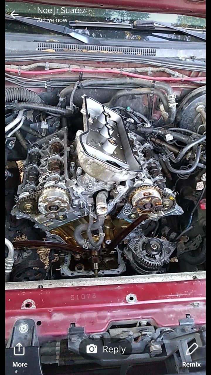

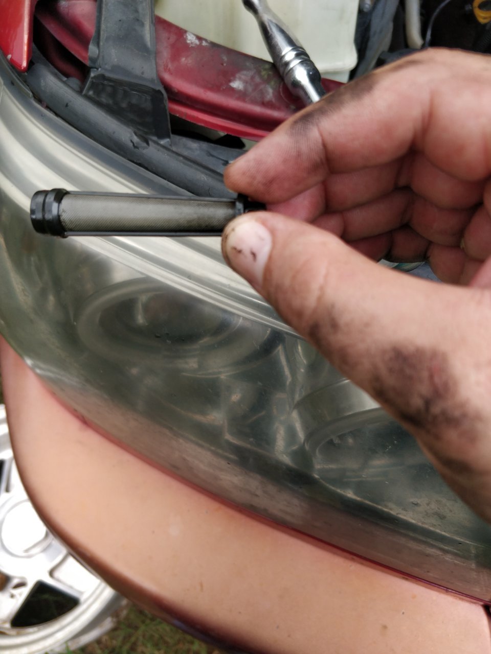

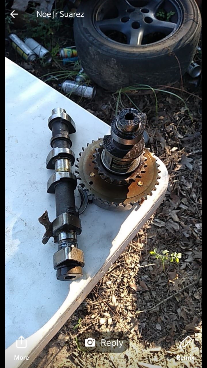

  19. Oct 7, 2018 at 7:28 PM
    #39
    morelia
    morelia Well-Known Member
    Mar 4, 2014
    #124591
    100
    conroeeee
    k&n intake. hid kit sound system
