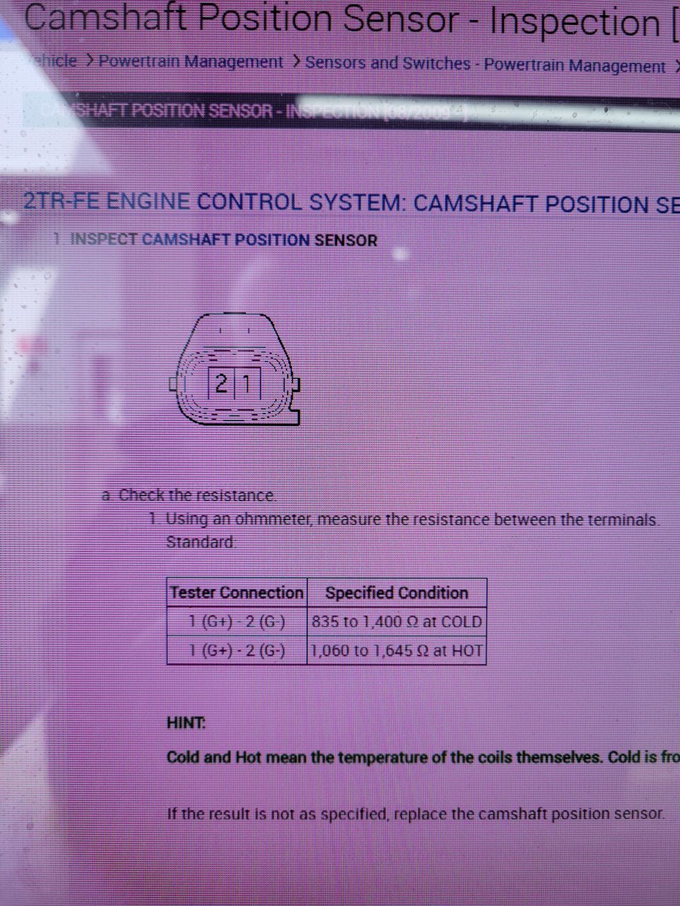

    what is the camshaft sensor ohms resistance for the 2.7 ?

    Right off the work computer

    thank you
