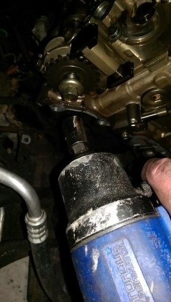

    I borrowed a 1/2" pistol style impact driver from a friend. My GF held the open wrench with a cheater to counter the motion. Came off easy breezy.
    Also, I did both bolts (on both sides of the engine) and my 4.2 gal air compressor didn't even need to refill. I think that compressor is fine for the occasional (rare) automotive air needs. Contrary to what our supersized, "BIGGER IS BETTER" society wants you to think, you don't always need the biggest tool out there...impact_driver.jpg
