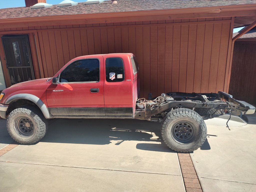

    For now the truck looks like this:
    I hope to find time tomorrow to get the work done and swap out the charcoal canister and roller valve (and want to do the fuel pump and sending unit as "while I'm in there items"). I'll keep this thread updated as to whether or not it solves my over-pressurized fuel tank problem.
