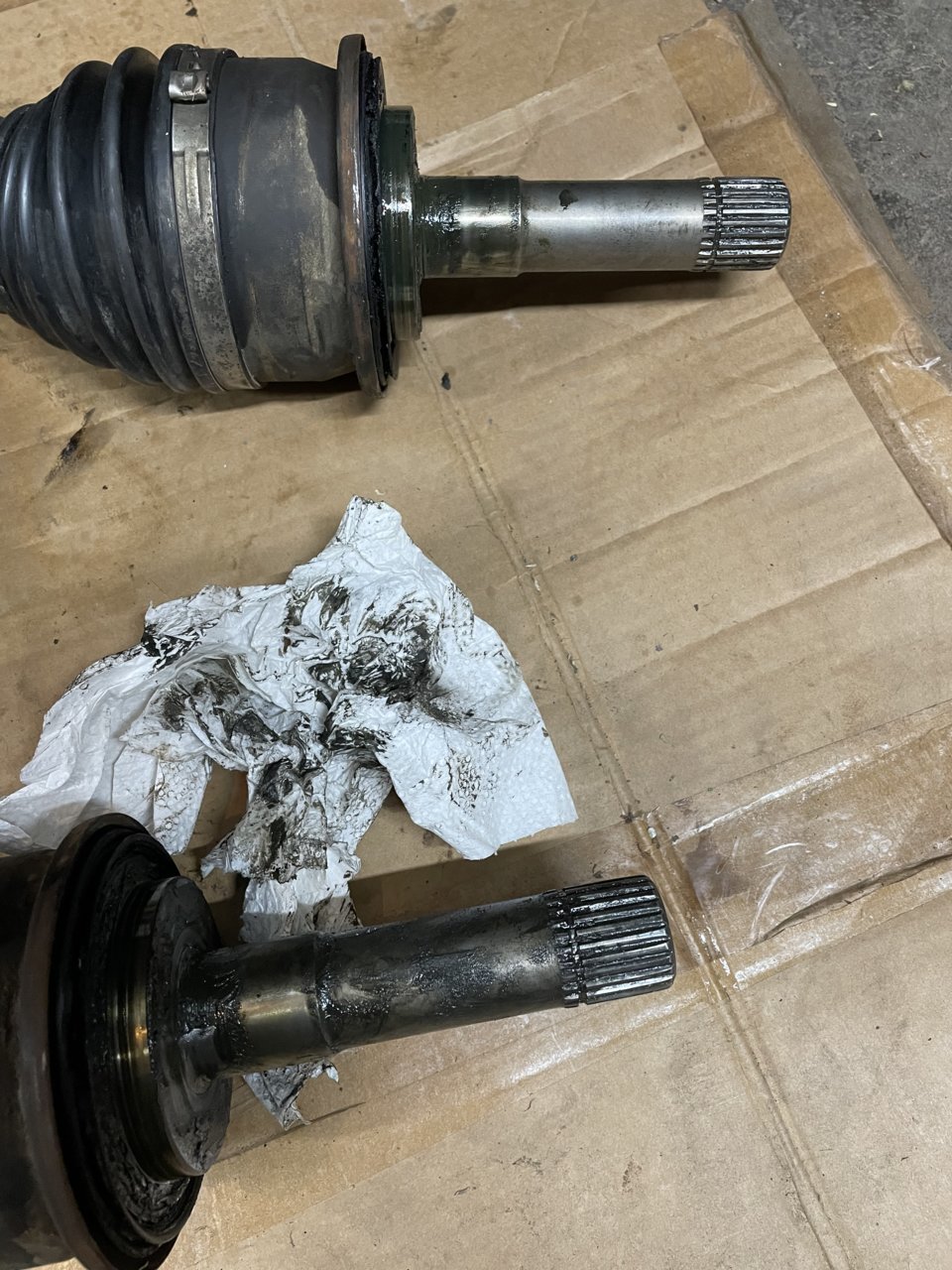

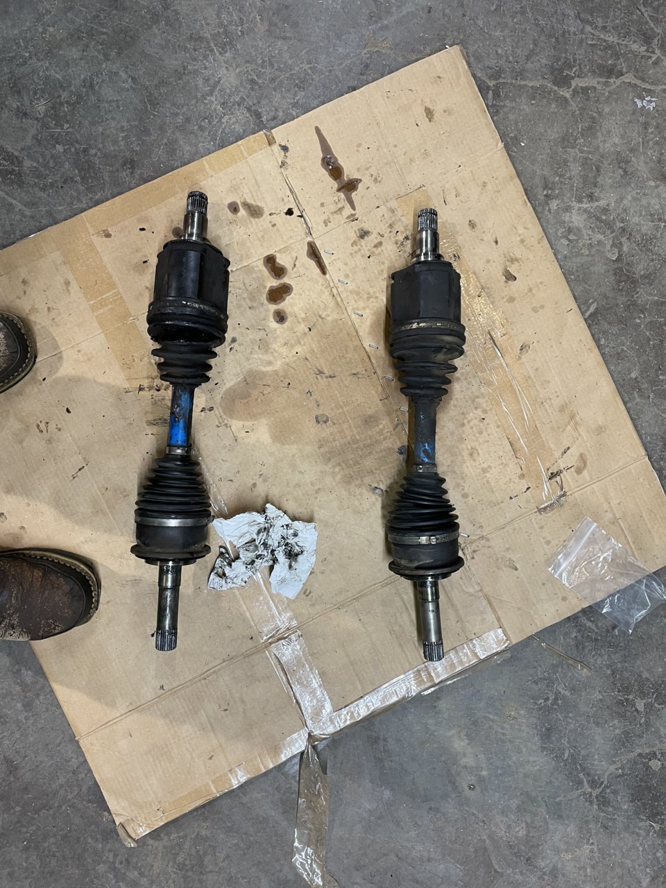

    I’m in the middle of swapping out the CV axles on my truck (04 4x4 v6) and I didn’t realize until I took out the old ones that the new ones I bought won’t work.
    The ones I bought have threads one one end that are for the axle nut, but with the manual hubs on my truck it won’t work.
    It turns out that since my truck has manual locking hubs the CV axles need to have splines on both ends instead of splines on one end and threads on the other.
    The problem I’m having is finding where to buy these parts. Everywhere I’ve checked from this forum and from sites I know only carry the CV axles with the threads for non manual locking hubs. Can anyone help me find the right CV’s?

    I went on rock auto and found what I think is the right part. I looked at the 2000 model tacoma and it is the same size and spline count as my old ones.

    Holy crap, what's with all the videos/pics that aren't able to answer your question?
    Buy reman cv axles, or just reboot your own if that's all they need. Factory/reman are the best choice for these vehicles.
    Just need to find a "free wheel" option, and disregard any "ADD" version.
    If you go to a parts store, just do a manual search and not use your year because manual hubs weren't available at the time.

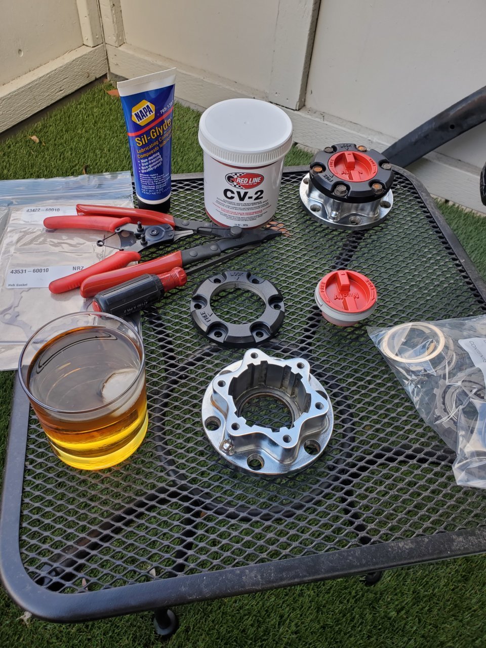

    As for grease, I used Redline grease for manual hubs, and sil glyde for the o-ring-

    Either previous owner did a 4x4 swap if the truck was a Prerunner, and went manual hub, or previous owner went manual hub and got rid of the ADD parts.
    It wasn't until you said this that I noticed it's the OP's first post, meaning he probably just bought his truck.

    Use an older year truck, you're looking for axles without Auto Locking Diff. Rock Auto has them.

    Do yourself a favor and rebuild your hubs while you're at it.
    Especially if this truck is new to you.
    First things first, you'll want an o-ring as I mentioned above. This deteriorates over time and allows water, dirt, and grime to enter.
    Lubricant for said o-ring; I used Sil-Glyde as shown above found at any Napa Auto parts store.
    Gasket for the hub assembly to the wheel hub; think I bought that at Napa Auto parts as well.
    A quality grease; Redline puts out good quality products so naturally I went to them for the manual hubs.
    Gear oil, as you'll lose some (totally normal) when you pull your CV axle out.
    Last but not least, since you'll have to replenish any gear oil lost, you may as well replace both the fill and drain plugs as they are the dreaded hex-style that easily strip out if you're not careful.
    Seeing as how you got your cv axles out, tells me you're not afraid of getting your hands dirty and figuring stuff out. Just as a precautionary, remove your FILL plug first. Depending on the front diff (if they swapped it out, they're all the same), it'll use a 10mm or 12mm hex.
    Your DRAIN will use a 12mm hex; remove that only once you've pulled your fill. Some have made the mistake of pulling their drain first only to strip out their fill, and not be able to refill their diff.
    Replacement parts for these plugs are 90341-18060 and 90341-24016, fill crush gasket 12157-10010, drain flat gasket 90430-24003.

    Here are some sources for manual hub parts; I've purchased these parts myself from this very vendor -
    Genuine Toyota® Locking Hub Gaskets - Yotamasters
    Genuine Toyota® Hub Dial O-Ring - Yotamasters
    This spring and detent kit isn't required, but it was necessary for 1 hub I rebuilt. The spring was broken and the ball had fallen out; was nice to have spare parts available when I needed.
    Locking Hub Dial Spring and Detent Kit - Yotamasters
    You can also just buy new hubs as they're directly available from Rockauto; make sure to use the coupon code found in this very forum! Several other vendors offer them as well, part number Aisin FHT019.
