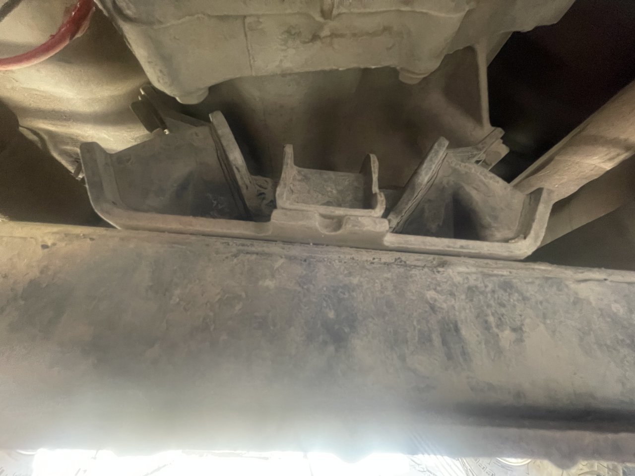

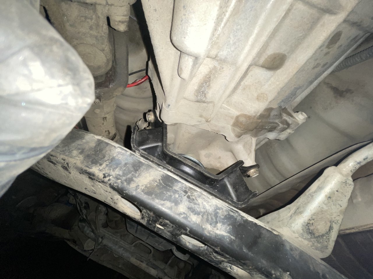

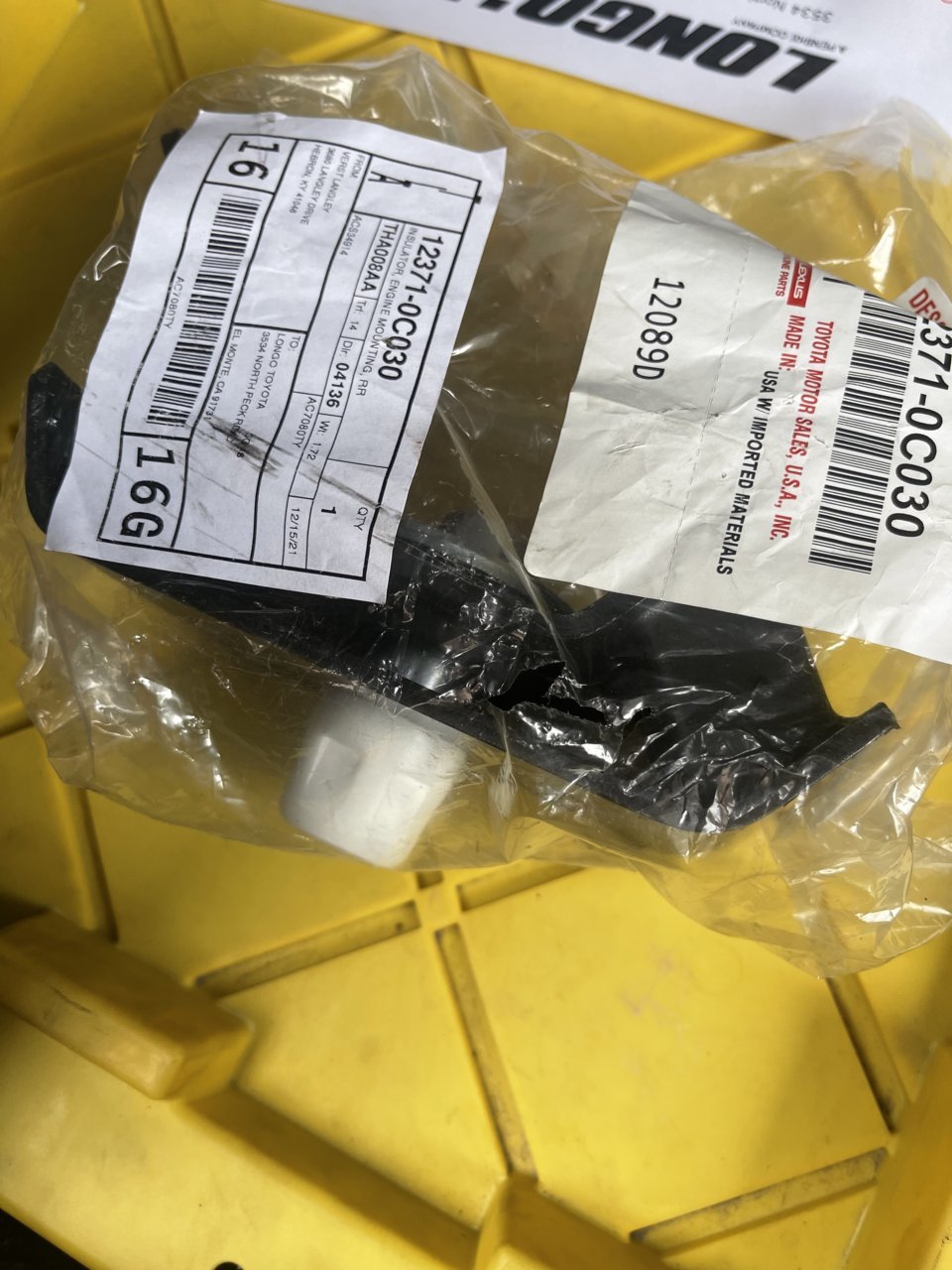

    AF32081D-9620-454E-A96B-C7DF3327A6F5.jpg 6F9D56E0-543E-4236-96FA-FF974ECB0A06.jpg So I’m happy to report that the transmount did indeed fit my taco. Use the new part number, it will say it doesnt fit on toyotapartsdeal but when I went to my dealers website it fit, to verify I gave the guy at the parts center my vin and said that part number is discontinued, I added that it is a new pn and gave him the new one that he said he couldnt see in his system 12371-0c030. This was a special order and took a week to get here. I hope this helps someone down the road.
