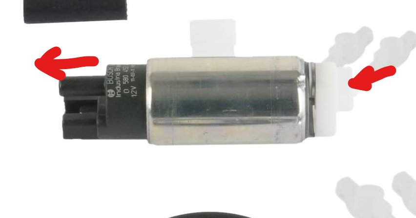

    From talking to a fuel pump engineer on a ferry tank project, it is not really about the fuel keeping the pump cool. Electric motors run all day long not dipped in liquid. Usually automotive pumps are not directly exposed to fuel and are in some type of fixture. The one on my bike is used in just about every older Ford and GM. The Taco pump itself looks very similar, if not the same. The fuel flows through the pump body:
    The real problem is the harsh environment of sucking to prime a dry pump. On the specialized side, there are specs for how long a pump is allowed to run dry, or if they are allowed to run dry at all. Given the nylon impeller system on most automotive LPFPs, I would bet it does not tolerate priming well at all.

    Well answered that question way better than. I expected. Good info I figured it did still require fuel to keep the pump cool and lubed but wasn't positive about it in the newer vehicles.
