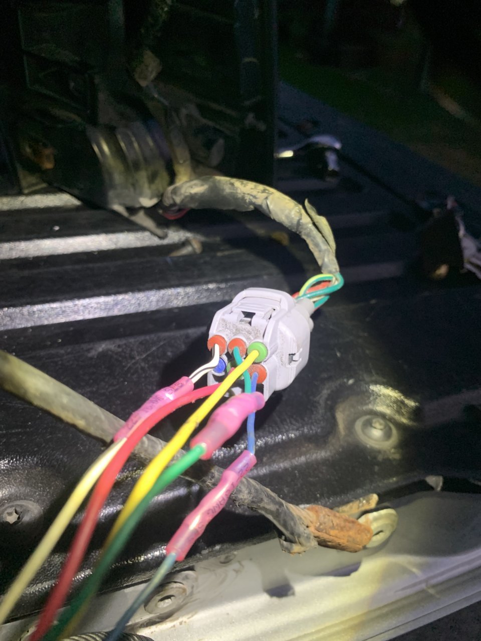

    I attempted to splice my truck cap 3rd brake light into my rear brake lights, saw tons of videos on how to do it seemed simple, & I needed to do it to pass a safety inspection In my state. I did a hack job soldering and never got the brake light to work so I cut out what I touched and used butt connectors to re attach the wires I cut. The codes I’m reading are Master Cylinder Pressure Sensor Zero point High, & Open Circuit in ABS Solenoid Relay Circuit. I can shift out of park using the override button but I still don’t have brake lights. Thx in advance.

    My man there are so many questions to ask. For starters, let's see some pictures of ALL the wiring you touched.

    You should be able to verify that the "butt splice" connections you made are good by testing continuity from the other tail light for the hot wire. The ground wire can obviously be tested using almost any metal source on the truck.

    spliced on the black and white top left on the pin(ground) and spliced on the blue(brake) bottom left. The green was cut but not spliced.

    These are solder centered heat shrink? Your connections look good, honestly. Verify continuity and then explore other options. If continuity is fine among all of these (I posted on how to test the hots, and grounds), your problem is elsewhere.
    I'd vote the guy below me is most likely culprit, you probably arced something during makeup of the wires. (Not being insulting, I'm an electrician by trade and do it all the time...) And blew a fuse.

    Have you checked the 2 fuses I mentioned above?

    IT WAS A BLOWN STOP 10A fuse!!!! You are the man Sir! Bravo
