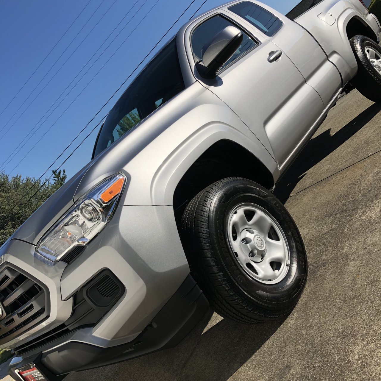

    im sure this has been asked before so I am sorry but in my 3 weeks of research I haven’t found anything about a 3rd gen AUTOMATIC with 33’s.
    I will be adding a leveling kit (3” / 1.5”) and looking to add some 275/75/16 or 285/75/16)
    Can my 2.7 AUTO handle this? I want to do it the right way so feel free to tell me yes/no but also please tell me WHY you said yes/no, and what I should and shouldn’t do to make this work.
    I believe that it has the 3.91 gears. I could be wrong but from what I understood from reading my driver side information I think it has 3.91
    Anyone done this yet on theirs? If so do you have pictures? And any input on what you felt after adding this size?
    I drive mostly highway and city, with the occasional off-road, but only trails similar to fire trails, green circle and blue square trails at the SRVA, and the occasional snow when I visit family once a year in Washington state

    Your truck looks great!!
    mikestaco17[QUOTED] likes this.
