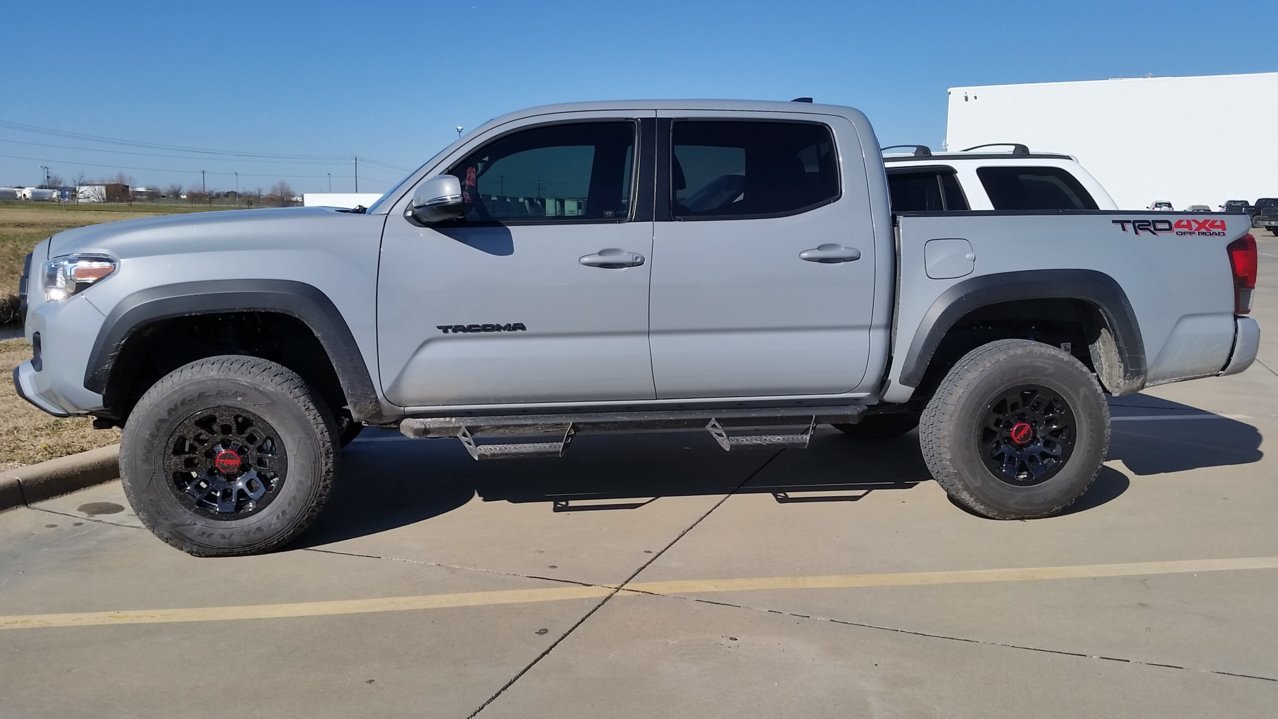

    I have 285s with a 2 inch level. I have 0 offset wheels though and I went ahead and did the CMC and pinch weld since I do go off road.

    TRD Pro suspension-2nd Gen Frontrunner bed rack Tacowiede radio knobs! Best mod everrrr!!! DSM mount Wheel swap to OR’s. For now... Gone-2005 DC Icon Stage 2 with Rear Resis;ICON 3 leaf AAL installed! Gone-2001 xcab 4x4 4cyl 5spd. Best truck ever...
    My favorite wheels. Just perfect.
    Nice job
