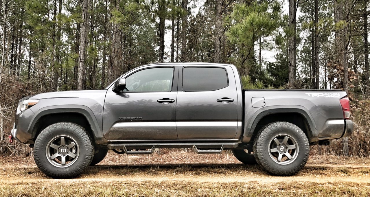

    2018 DCLB TRDOR
    285/75R16 KO2s, 2in Eibach Pro, 4.88 Yukons, OVTune 1.05
    I like the titanium looking wheels with MGM. What brand are those, they look like 17 inch?
    Thunder Fist[QUOTED] likes this.
