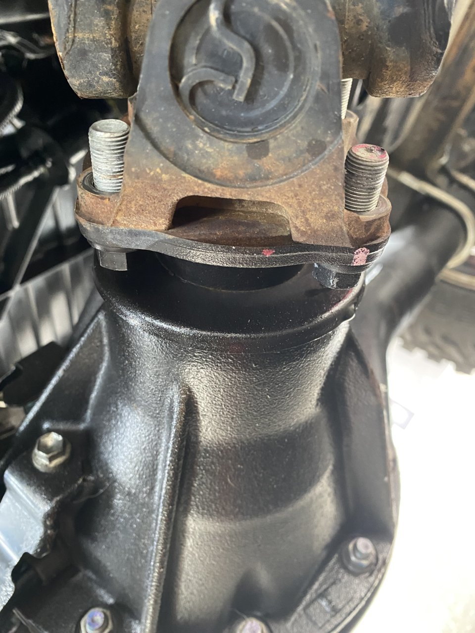

    Am I crazy or did the shop put these bolts on backwards?
  10. Mar 30, 2023 at 11:11 AM
    3JOH22A
    3JOH22A トヨタ純正男娼
    Mar 27, 2019
    #288172
    13,102
    District 6ix
    3G Tacoma on 35"s, 5G 4Runner
    ^On the 3rd gen OR diff, those bolts are studs pressed into the pinion flange. (To remove the driveshaft, you would compress the driveshaft for the yoke flange to clear the studs.) The nuts are missing.

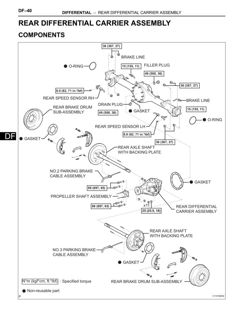

    I took the nuts off to replace the seal but cant figure out how to remove the bolts (studs). Are 3rd gens different than 2nd gens? Cause the 2nd gen diagram shows the bolts facing the other way

    ^Yes it's different on 3rd gen OR. To remove the driveshaft, you would compress the driveshaft for the yoke flange to clear the studs.

    That's the diagram for the rear pinion.

    Your driveshaft yoke studs are how they are supposed to be.
    No, neither tires nor the gearing itself ruined the seal. The pinion itself is under less stress with 5.29 and 35's than it would have been with stock gears and 31's. The seal was probably poor quality or not installed right. I'd go with OEM for the seal. Would be interesting to know what part was used originally.

    I don't think it matters which way the bolts go in, as long as it's torqued properly. I never remember how they came from the factory so I just guess when reassembling and I've never had an issue.

    There's no room to pull them out is why I think they're backwards. They would run into the metal cover behind them. Anyone wanna be a bro and check their truck before I start wandering around the neighborhood looking for a 3rd gen to crawl under
