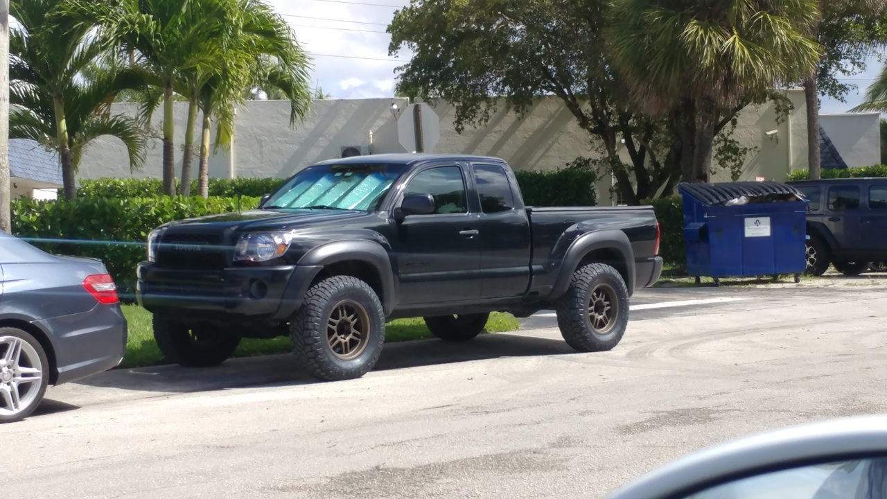

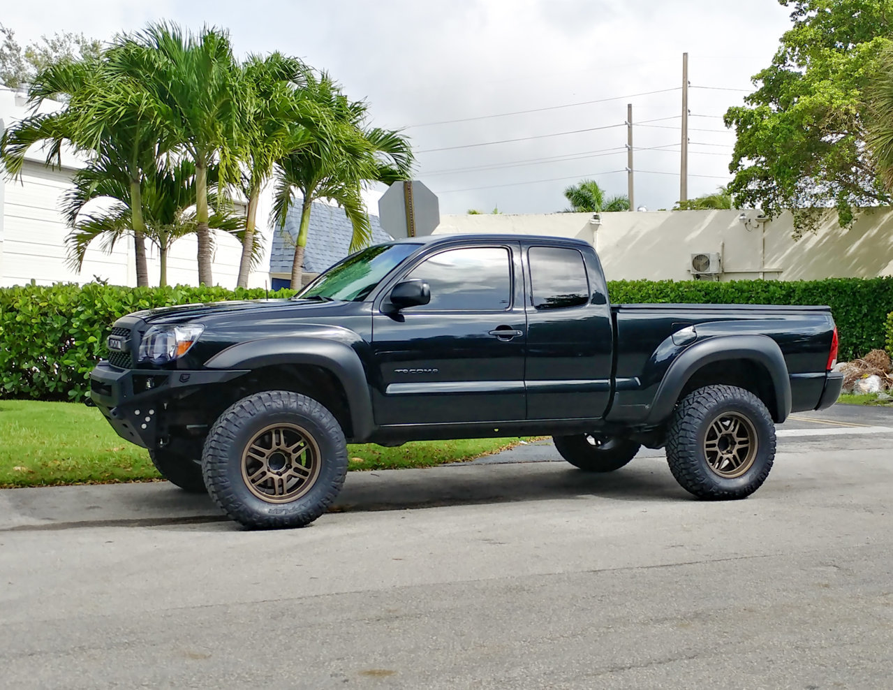

    I ran my 285/70R17 on a level for a week or so, rubbed like hell. Did frond and rear lift and 98% rubbing is gone, need to do the CMC and trim fender a hair.
    Leveled
    3.5ish/2.25 lift

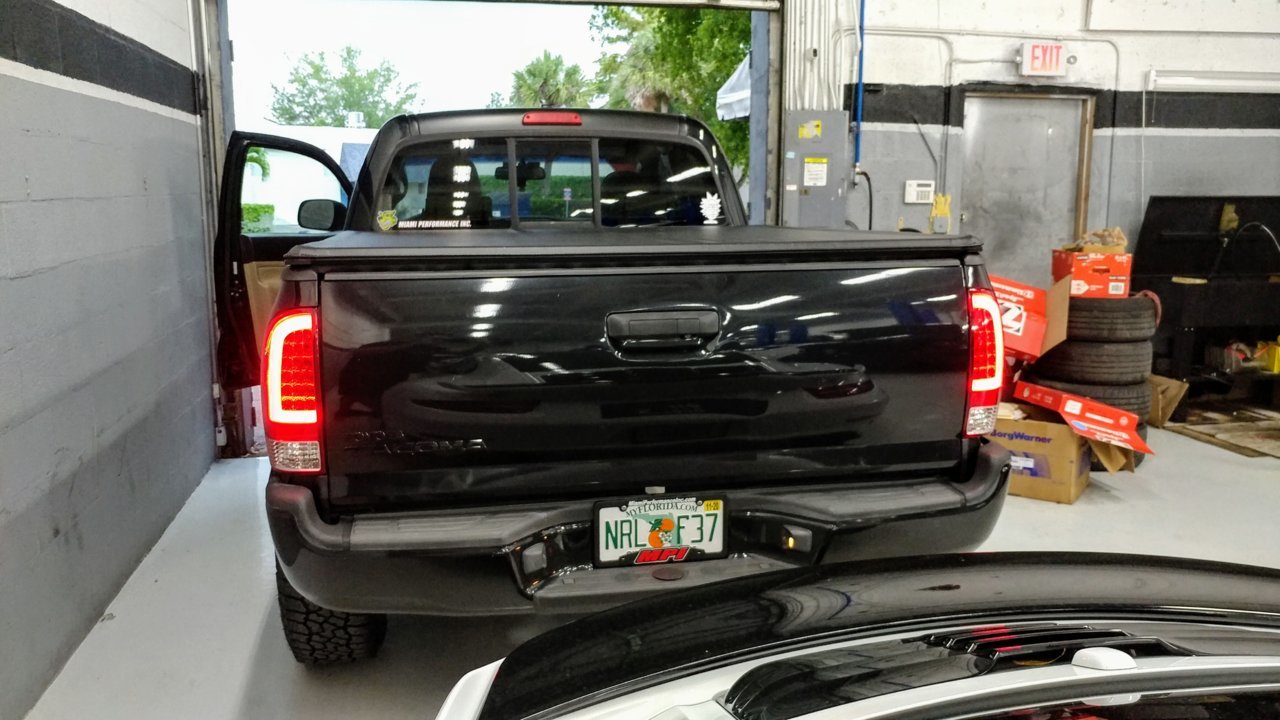

    got pictures of your truck from the rear? i want to see those tails
