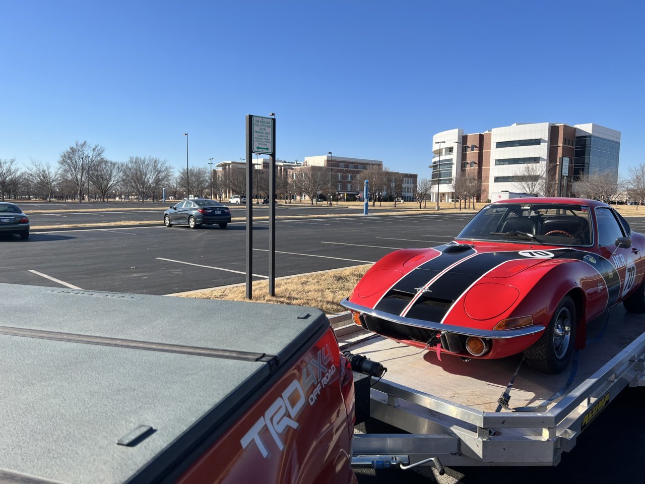

    Same! Every other weekend. I have trailer brakes, but I can’t be bothered to plug in my controller. Don’t really need them.

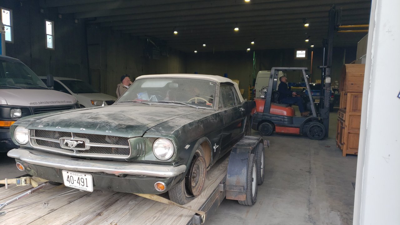

    65 Mustang from Kansas City to Columbia with mine, no issues. Kept it in S5 for safety.

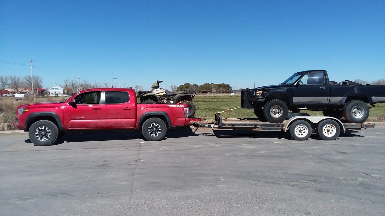

    Went about 600 miles. No trailer brakes. Two trailer tire blowouts. I hate trailer tires. My truck is a manual but there is no reason a slushbox can't tow too. Like @OpelGT said, you have to adjust your driving to accommodate, don't just drive like you normally do. 20200208_122243.jpg
