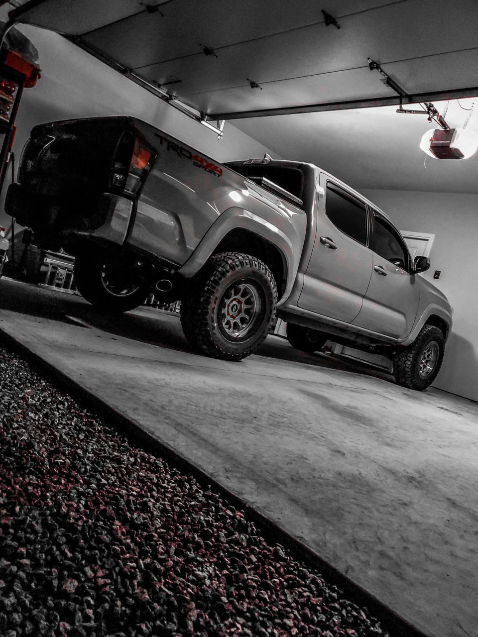

    Technique
    Technique Well-Known Member
    Nov 4, 2017
    #235046
    2,923
    Alex
    Utah
    2017 Silver Offroad DCSB
    -285/70/17 Toyo AT3 -Tuned
    I did yeah, I even still rubbed a little bit after I lifted 1.5"~ on the mud flap area. I've since moved on from that setup. I have 33" MTs on. Did some cutting for those and I still rub a little in reverse lol
  11. Aug 26, 2020 at 8:24 AM
    angelot209
    angelot209 [OP] Member
    Nov 29, 2019
    #312016
    10
    Angelo
    2020 Black Tacoma Sr 2wd
    damn thats a beautiful setup. what rims are you running?
