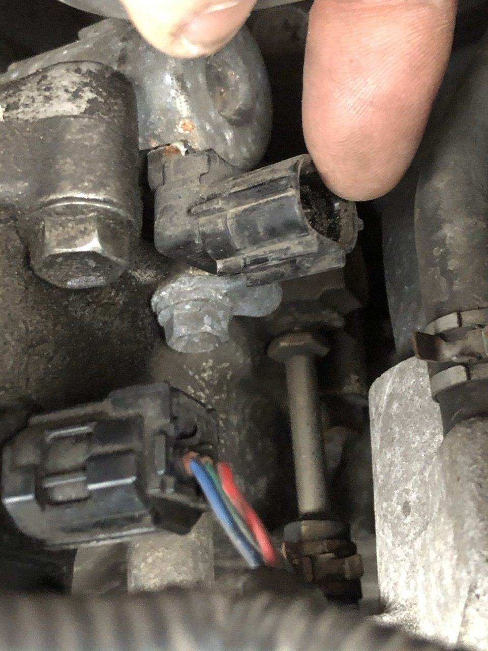

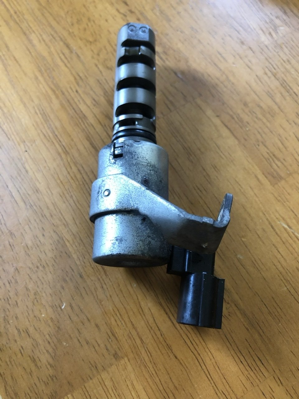

    I replaced one of mine that I accidentally broke. Started and drove with no power going to it but never had any noises as a result.
