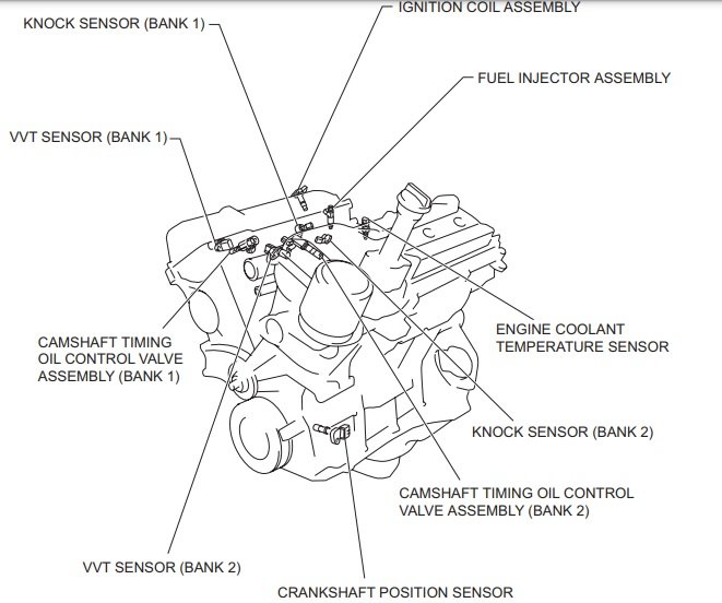

    OK, next question: where are they?
  4. Feb 3, 2024 at 6:29 PM
    #44
    Dm93
    Dm93 Test Don't Guess
    Mar 3, 2015
    #150066
    13,802
    Texas
    2014 DC OR 6spd 4x4
    Predator tube steps, Ranch Hand grill guard, Magnaflow CatBack exhaust, Toyota tool box & bed mat, 2LO Module by @Up2NoGood, Rearview Compass/Temp Mirror, Tune by @JustDSM.
    In the valley pretty much directly under the throttle body.

    Thanks!
