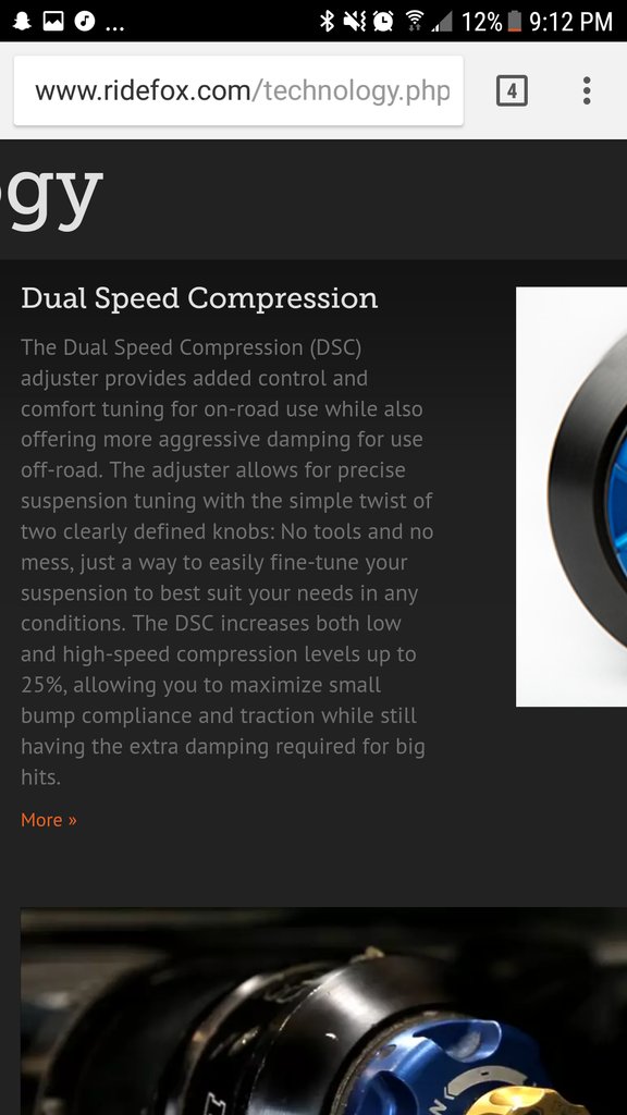

    That's one of the selling points on (I believe) fox 's click adjuster. I'm sure it would take some play to figure out what setting you like but then you could just use a paint pen to mark loaded and unloaded settings and just click it to the desired setting as needed.

  5. Aug 18, 2017 at 8:18 PM
