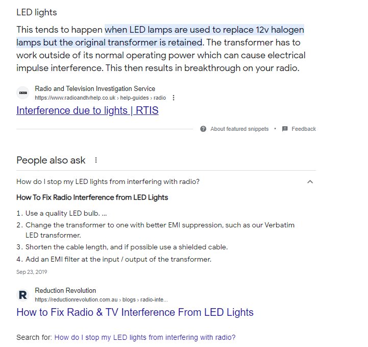

    Just a quick search of LEDs interfering with radio brought up a bunch of hits.
    Dm93 likes this.

    Yep LEDs can interfere with radio signals depending on how they are driven and what kind of filtering circuitry they have in them, the cheap chinesium ones tend to be the worst in that area.

    Sure thing. Generally it's the lower cost ones that cause the most problems like these. Some people run them and have no issues at all, and then the unlucky ones have nothing but fits if they don't pony up for fancy/better made LEDs.

    If you capture high frequency data you can build yourself a band stop or out of band rejection filter with a simple RC network. For all the trouble it’s worth to do that it’s probably easier to just buy a quality LED kid that doesn’t produce unwanted noise on the power circuit.
