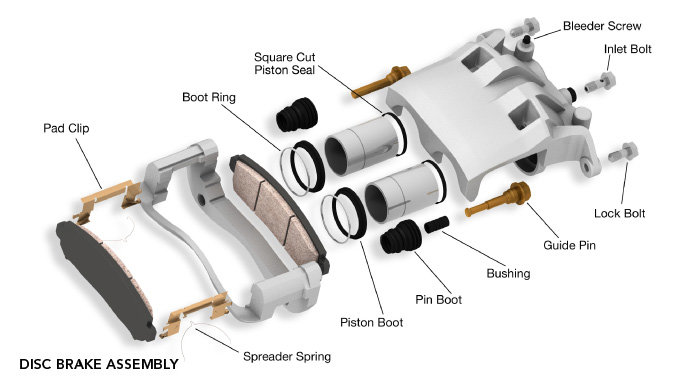

    OP, glad you got this fixed. Sorry, haven't been on for a while. I realized I should have been clearer. The springs I was talking about are the pad clips for the disc brake pads. Depending on the vehicle and pads used there can be a clicking noise from the brakes when applied and released when they wear. They apply a spring like pressure to the pads within the caliper bracket.
