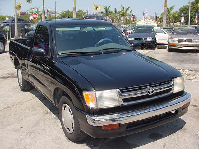

    This is not my truck but this is what it looks like and i wanted to put this lift on it do you guys think its a good choice and woould i be able to fit 32s??
    lift im intrested in:
    http://performancelifts.com/cgi-bin/cart/FTS4130-4.html
    And also would you guys recomend getting the shackles??

    You wont fit 32's with that kit. Maybe 31's. Shackle lift for the rear is a good choice.
