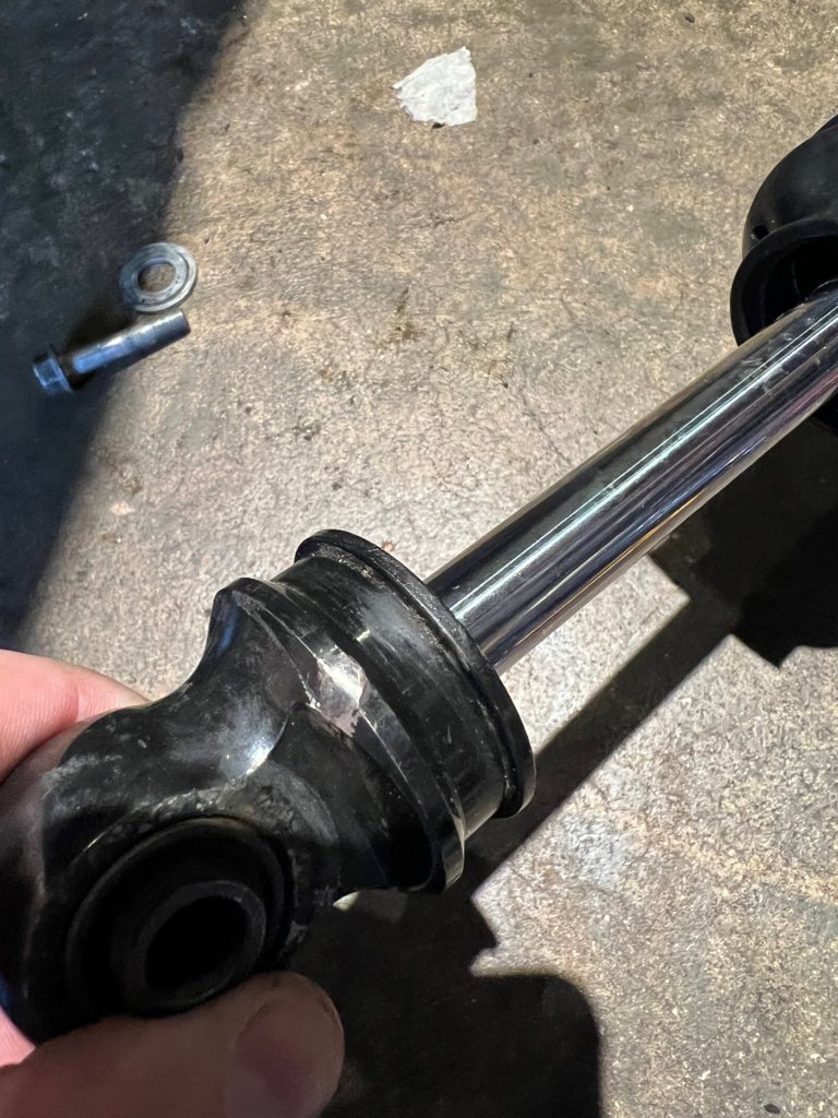

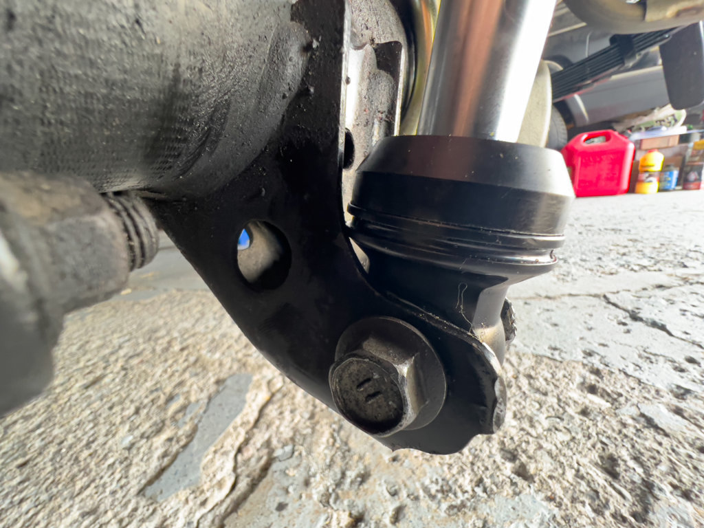

    I think that I may have found it. I inspected the lower shock mount on the driver side and found this. I remember thinking that there should be more clearance when I installed them about a year ago. Bushings are good and the shocks didn't move in the mounts at all. Has anyone else run into this with these shocks?

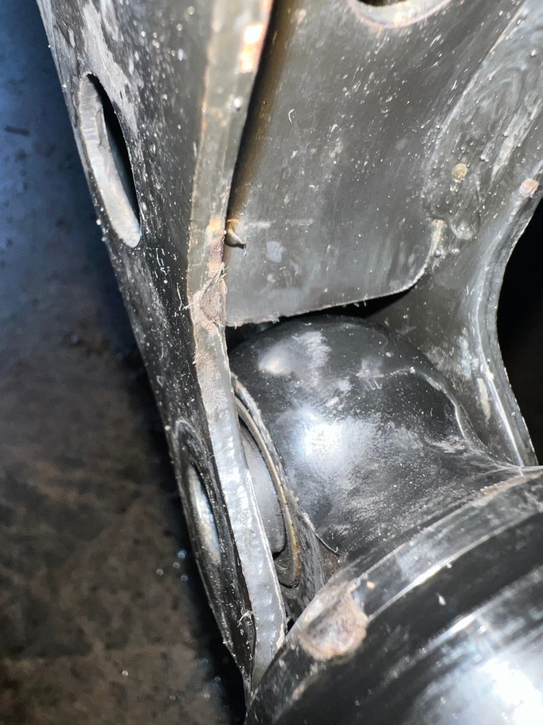

    That's a good find and if it's your culprit would be the easiest fix. I'd take a grinder disc to where it hits the mount on the axle and give it a little extra clearance, then a little spray paint and you should be golden.
    I noticed similar clearance issues when installing my lift which consisted of Deaver U402 stage 2 leaf pack + Fox 2.5 Performance resi shocks which is similar to yours in height and components. The lower rod ends they put on these things are so freakin oversized compared to some others I've seen. I get why but boy do they use every millimeter of clearance (and sometimes a little extra). Mine don't make noise and I think they have "self clearanced", but if mine did make noise from that same contact point I'd do the same thing and massage it a little with the grinder.

    I also had to grind down my rear shock mount slightly in that area for clearance with my Dobinson's on my left rear side.

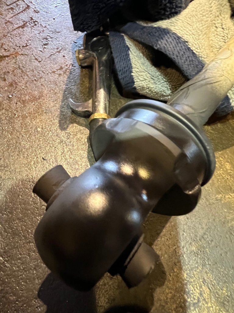

    I think the fact that I am running 2.5 degree angle shims could be the difference between clearing and not clearing with the Dobinsons. I think it makes the driver side worse and the passenger side better due to the reversed orientation of the shocks. I haven't pulled it yet but I remember the passenger side not being as close.
    I'm grinding the shock instead of the mount as it is less permanent. Hopefully the noise goes away. Even if it doesn't I'm glad I addressed it.

    I notched out both sides even though there had only been contact on the one.
