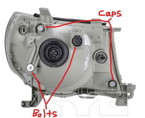

    Currently dealing with the moisture-in-headlight problem that seems endemic to these assemblies, and having read all the threads I could find around these parts on the topic.
    My question is, does anyone know more about what these various things are on the back? There are two gear-like bolts (one of which is even capped to prevent turning, I presume?) and then two white caps which have a cushion insert.
    Mostly just curious--thanks!

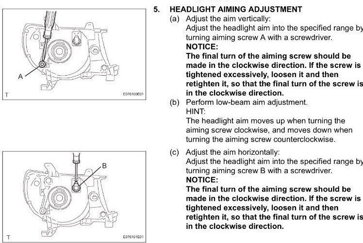

    @chockomonkey Are your headlight buckets stock or aftermarket? Also, check the rubber boot that the light sockets snap into. I have 3 on my headlight assembly, side marker, turn signal and the headlight. In case you're wondering.

    The moisture issue is unrelated to any of those items you see on the back of the light - unless you're actually submerging the light in water. Otherwise, it's almost always water getting between the housing and lens. But as mentioned, if the seals are missing or damaged you could get water in thru where the bulbs enter the housing. The headlight bulb will have that large rubber cover and the other two will have integrated rubber o-rings I believe. Aftermarket lights are known to leak. OEM ones are much less likely to leak and will probably only do it after a good amount of time has passed whereas aftermarket often leak when brand new.
    Other than buying new lights the solution is to pull the housing and lens apart, remove the old sealant and apply new sealant. To do this properly the light must be taken apart, don't expect to just add sealant at the seam with the headlight still in one piece. DO NOT use products like silicone caulking you bought at Home Depot. The proper sealant is "butyl rubber":

    Thanks everyone! I'm pretty sure these are OEM assemblies based on the various photos I've seen around. The reason I was looking on the back to begin with was a couple mentions in these moisture-issue threads related to popping off caps on the back to let things dry out.
    I'll take off the boots (only have these on the main headlamp) and bulbs to inspect the quality of the seals and go from there. It's been SUPER hot and dry up here in the Puget Sound so I'll probably just leave the bulbs out to help let things dry out.
    Are the white caps helpful for drying out at all? What purpose might those serve?
