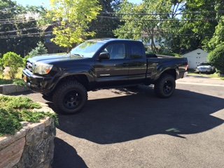

    Here is the background: I have a 2005 Tacoma. It is in good shape and has low miles (I just cracked 55,000). The truck has a lift kit and Nitto Grappler tires on it. I didn't do the lift and I didn't pick the tires (that's a long story) but rather bought it that way. Recently I put a rugged bumper on the back (along with a tow hitch). You can see from the picture how she looks today. And, yes, I have a bit more work to do. Don't we all?
