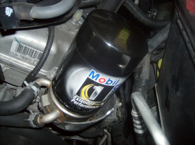

    The easiest way to tell is to look for the transmission cooler in front of the radiator on the drivers side. Also, look for the engine oil cooler hoses under the the engine oil filter.
    The pink fan clutch is not a positive way. Some people have reported a pink hub with no towing package.
    This is the engine oil cooler.

    Check for: 27 battery, receiver with a 7 pin plug, transmission cooler if you have an auto, oil cooler as pictured above, larger alternator...or download the app and search by Vin but I've never done that for my truck.

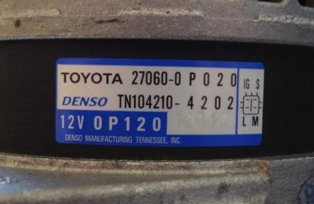

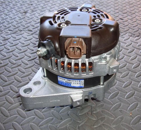

    Can you look at the alternator and tell if it is the 130? What to look for? Thanks.

    See pics. If it looks like that it's the 130amp one. This is from a 2014.
