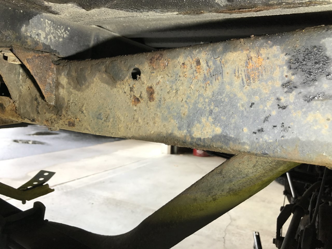

    Hi guys,
    I'm starting the project today of fixing my rusty frame and was looking for some help - I apologize since this has been covered before, but I wasn't able to find the info I needed in other threads.

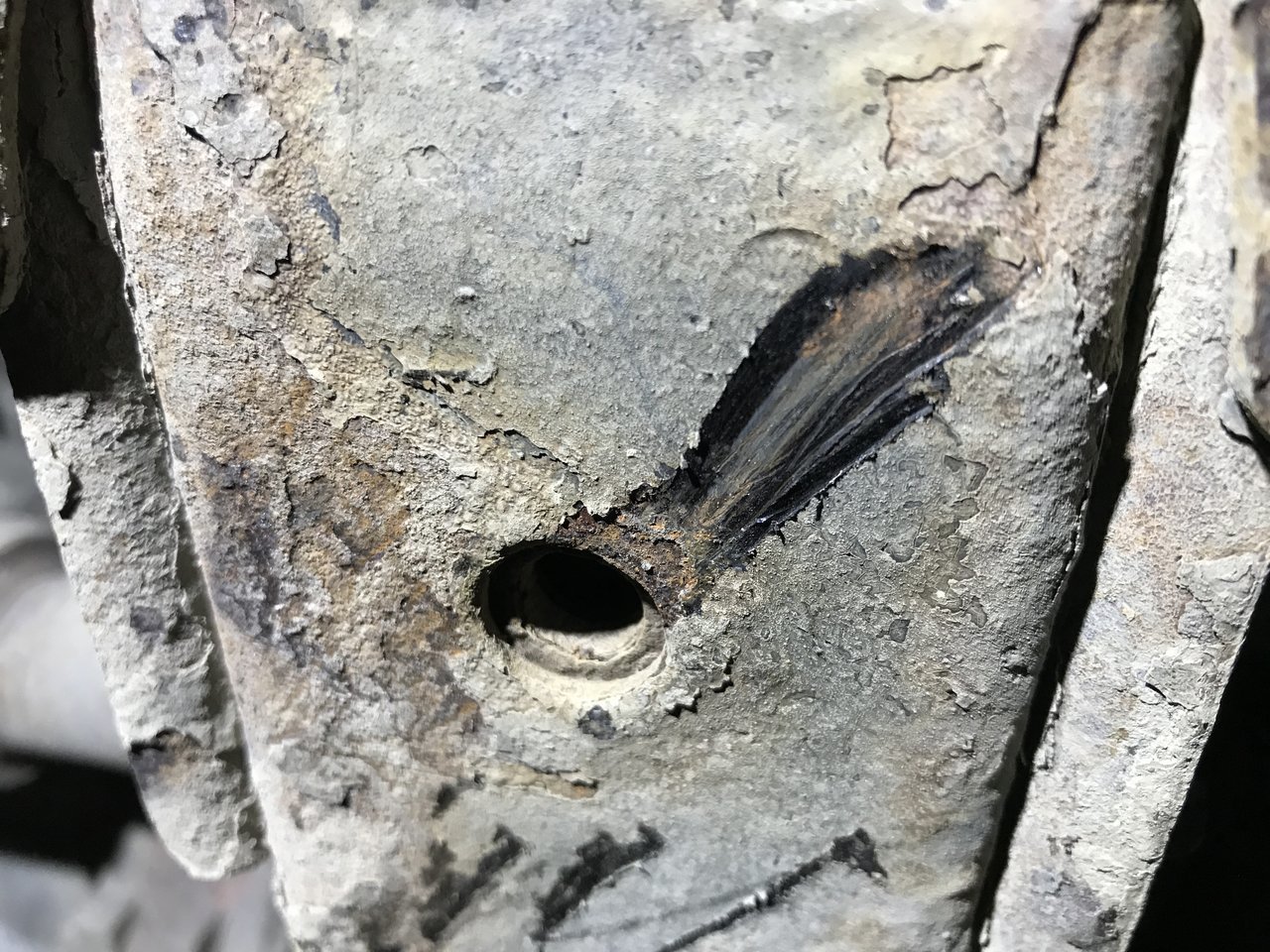

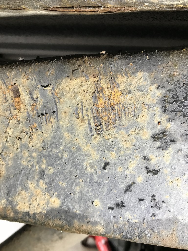

    So - I was in the middle of prepping to coat my frame with Eastwood Rust Encapsulator, and I noticed that there are some sections of my frame with a rubbery undercoating of some sort - not everywhere, just in sections (not much of anything in the middle part of my frame, but it's there on the outside of the C channel in the back and also there towards the front of my frame in places.
    Could it be Toyota's undercoating that's just mostly worn off at this point? I had my local stealership take a look underneath and the tech said that it hadn't been coated by Toyota, but he only glanced underneath and I'm not sure I trust him. Nowhere in the PO's service records can I find any indication that it has been undercoated by Toyota, but I can't be sure of this.
    Also - the truck was originally a Canadian truck, and lived its whole life in Calgary, AB before being imported into the U.S. and sold to me. Do the same frame replacement rules apply to Canadian trucks? Was the dealer undercoating an option in Canada?
    I doubt it will affect anything regardless, as I don't have any holes in my frame, but it wouldn't hurt to get it checked out by Toyota just in case before my 15 years ends in December of this year.
    Also - will it void my chances of getting a frame replacement all together if I coat it myself today? I'd like to start applying the rust encapsulator, but I don't want it to end my chances of getting a new frame.
    So let me know what you guys think! :D

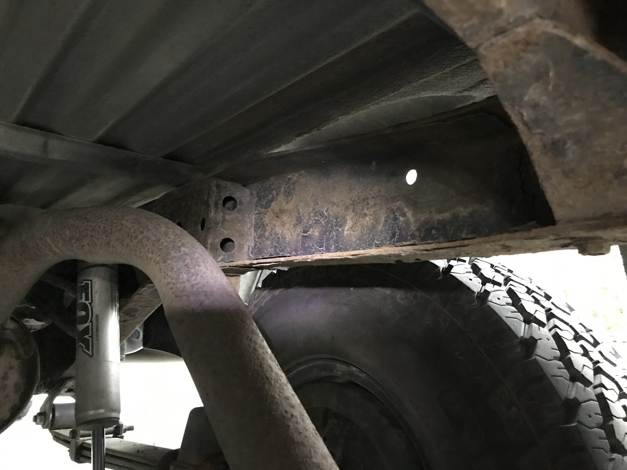

    Inside of the frame - NO sign of any undercoating, or it's all worn off by now.
    Outside of frame in places where I've scraped off part of the rubbery stuff.

    it sort of looks like the goop they put on mine. but the fact there is no record of it being done could mean someone applied it themselves or had a professional shop do it.
    as far as the warranty, hopefully a northerner will chime in :)

    Only way to know for sure would be to call Toyota Corporate (not a dealer) and have them run your VIN to see if it was done

    Same warranty for Canadians trucks. Mine was undercoated by Toyota but they replaced it last year due to intense rust holes.

    Thanks for the replies everyone! So I just called Toyota corporate, and my truck was indeed sprayed back in 2009. So now my question is - is it free to get my truck inspected by a dealer? Or do I have to pay to do this? If it's free I might as well do it, but if not then I'm not sure, being that I'm 99.9% sure there aren't any holes (there are a few thinnish spots, however)

    You should inspect it. They hit it with a hammer so maybe the thin spots will fail.

    That's good it was sprayed, if they inspect it and it fails it will qualify for a new frame (at least it should) through next year. Provided you haven't had sliders or anything else welded on to the frame that they could use as an excuse to void the warranty. Not sure that they would but I wouldn't put it past them.

    So guys, I took my truck in today to have it inspected and, as expected, they found no holes. So it looks like in a week or two here I'll put on that Eastwood rust encapsulator - I was hoping to do it with the bed on, but it's looking like it'll be a lot easier if I just pull the bed off.

    I can't believe they found no holes ....:annoyed: I saw another member
    https://www.tacomaworld.com/threads/matthewmay1s-build-thread.354786/
    with way less rust and his frame got replaced last June. If you still have the time until December and you had open the case # with Toyota Corp. I will look another Toyota Dealer for a second inspection , second opinion because just by the pictures and the fact you were undercoated back on 2009 you should definitely get a new frame on their dime
    The guys that did your inspect didn't seem interest on helping, they may have no experience doing it or whom knows why they declined this work or the help is just a matter of LUCK , some they get their new frame easy some don't, if the terms expire Dec 2017 I will tireless look for the frame replacement before any kind of DYI spray that will cover reality , that frame looks very advance rust but it just IMHO. ( in my humble opinion) ..... God luck ... let us know the outcome ...:thumbsup:

    Thanks for the advice. I'm not surprised that they found no holes though, since I have poked and prodded around everywhere underneath the truck and more solid than it looks in the pictures. It's also deceptive - I've seen pictures of trucks with pretty rusty frames that are okay, and pictures of trucks with near-perfect looking frames that have holes in them since they rust from the inside out. All of the dealerships within an hour's drive of where I live have very limited knowledge on the issue, probably because they aren't very familiar with the issue (at least with the first gens) and they don't seem like they've done any frame replacements in the past. I'm not in the rust belt, so most of the frames around here aren't as bad as the ones over to the east, even though they do use salt/chemicals on the roads here in the winter. And the rust encapsulator I'm applying isn't just some rattle can undercoating, it's a brush-on encapsulator that seals the rust in and prevents it from spreading, but is much heavier duty than the spray-ons (which I agree are crap).
