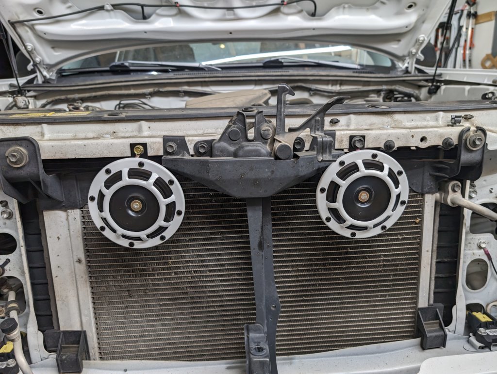

    Hella super tones or sharp tones are cheap and you can use a spade connector so you can crimp on a new connector. and clock the horn to get to the connector without needing to tap, or solder in more wire, or add a couple more connectors and run both sets of horns

    Easy enough to replace with Hella, or Hella style, horns. I swapped mine out for a set of Slickspeed Hella copies and they have worked great. I did add a relay just because of the extra amperage draw. Probably doesn't really need it but I had everything for it in the garage so I did it.

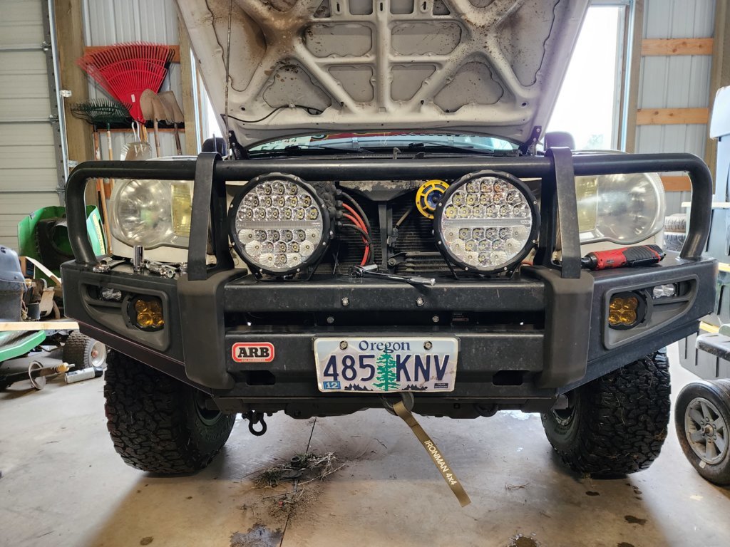

    BigCountry762x39
    BigCountry762x39 Well-Known Member
    Dec 13, 2022
    #413129
    1,907
    TL
    PNW, Oregon!
    2009 Tacoma, with the cool white paint peel
    Arb Deluxe bull bar Front Bumper Ironman4x4 12k winch synth line AFE Intake OME 2.75in Dakar Leaf springs (R) Fox 2.0 bypass shocks (R) Bilstein 6112 (F) 33's on KMC wheels off road lighting comfort mods Redrock HD roof rack Retevis rt95 Radio Slotted Rotors and HD pads
    You can just see mine peaking out behind that light
