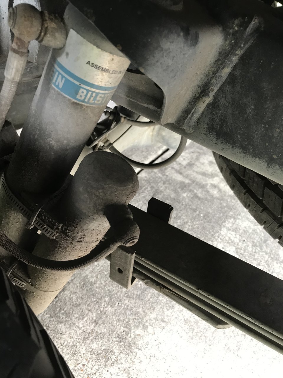

CAN ANYONE TELL ME WHAT KIND OF SHOCKS THESE ARE

    Shit bolted onto other shit, and junk.

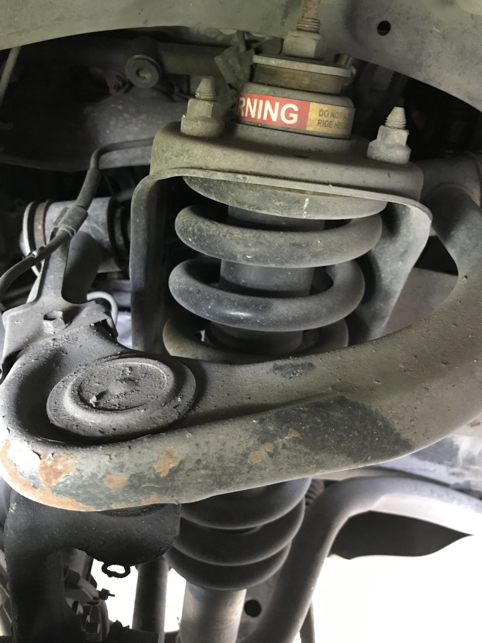

    Look like Bilstein 5160 on the rear with the resi. Can't really tell on the fronts.

    Looks like 5100 in front and 5160 in rear

    So I’m looking to upgrade. Any ideas..... should I keep the same (just newer) or go with another brand like icon or fox??

    very personal decision pending on what you need/do/want. However, the more boutique names like Fox, ADS, ICON, King are often widely considered upgrades over Billy 5100s or 5160s.

    Thanks for the info... Im not planning on scaling rocks or mountains... just a weekend beach sand driving and country road mudding. Any recommendations?

    These will do 100%. If you do upgrade you could just sell me these :cool:

    look at OME or just replace the bilstein shocks with new ones if your current billies are pooched

    Unless you really just want some shiny stuff under your truck then I would stick with bilsteins. Especially if you consider sand/salt wear, then they are inexpensive to replace and not really any issue to dial in.

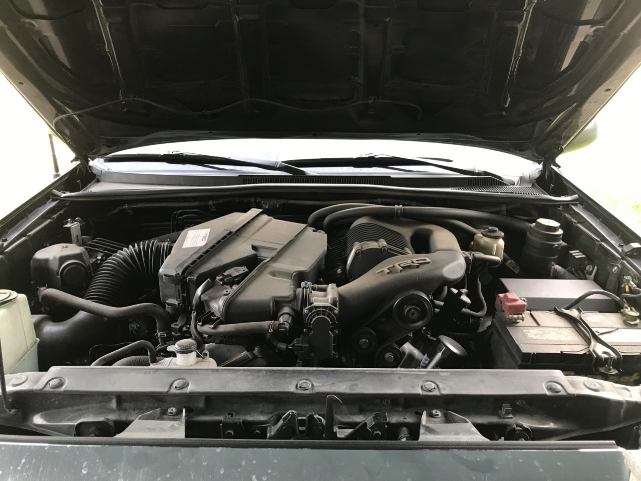

    Or should I spend on upgrading my supercharger 54EE4778-5D04-4C57-AC96-2F241E846992.jpg

    YES!!

    Push down hard on the front bumper a couple of times then watch the truck. If it rebounds unevenly or keeps bouncing, then the shocks are giving up. Repeat for the rear bumper. If everything feels alright, then the very good Bilstein shocks you have are just fine. Instead, invest that $2,000 into some mutual funds.
