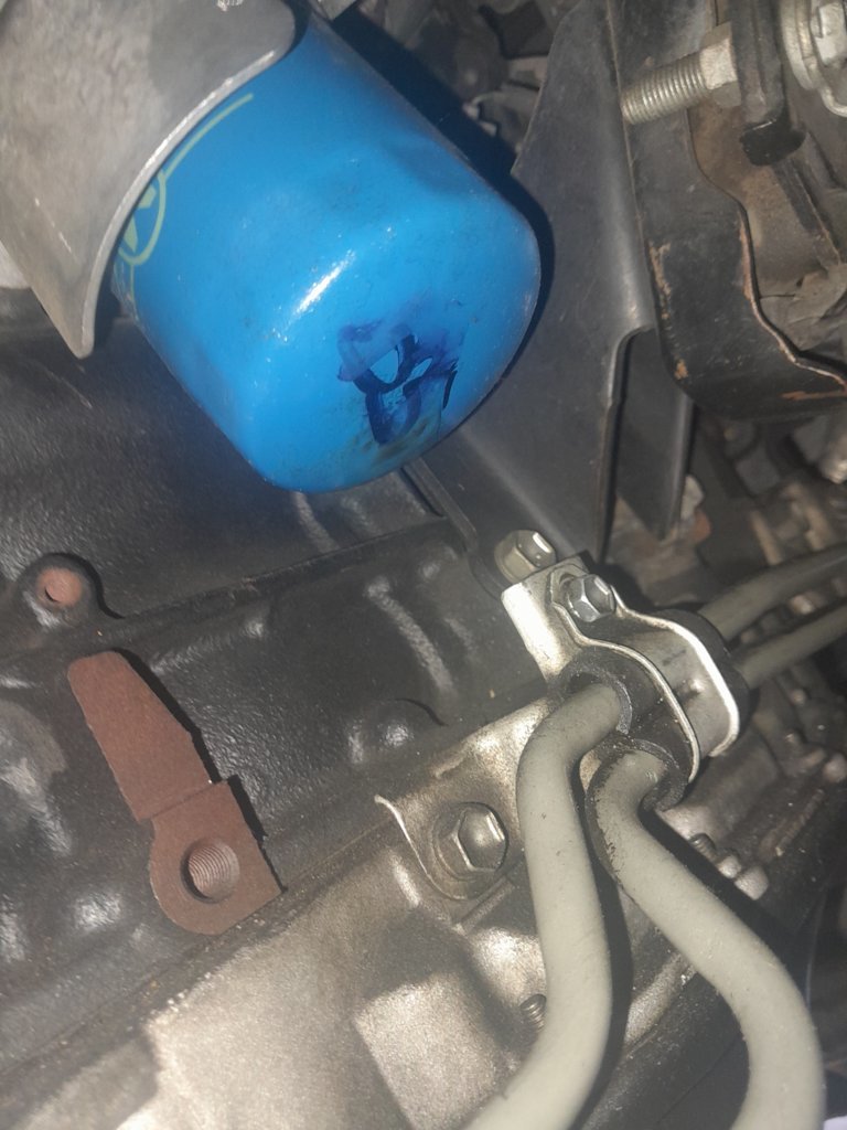

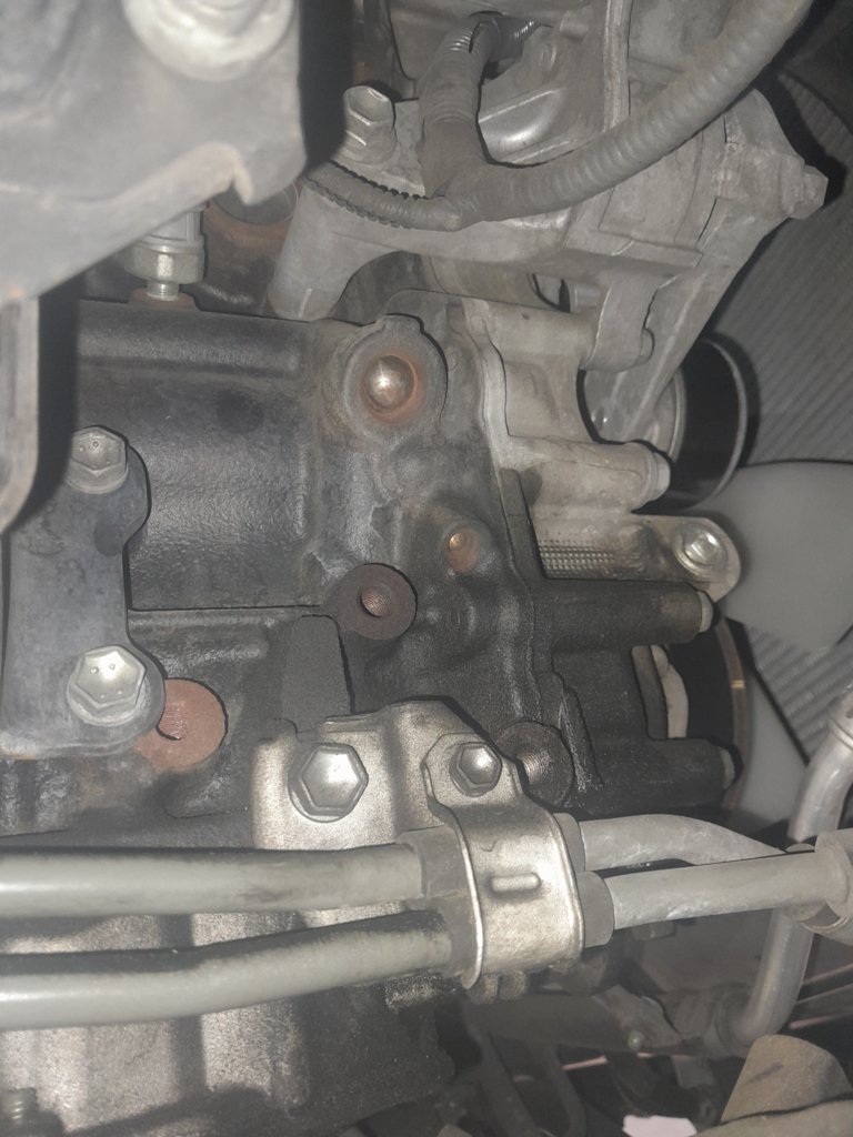

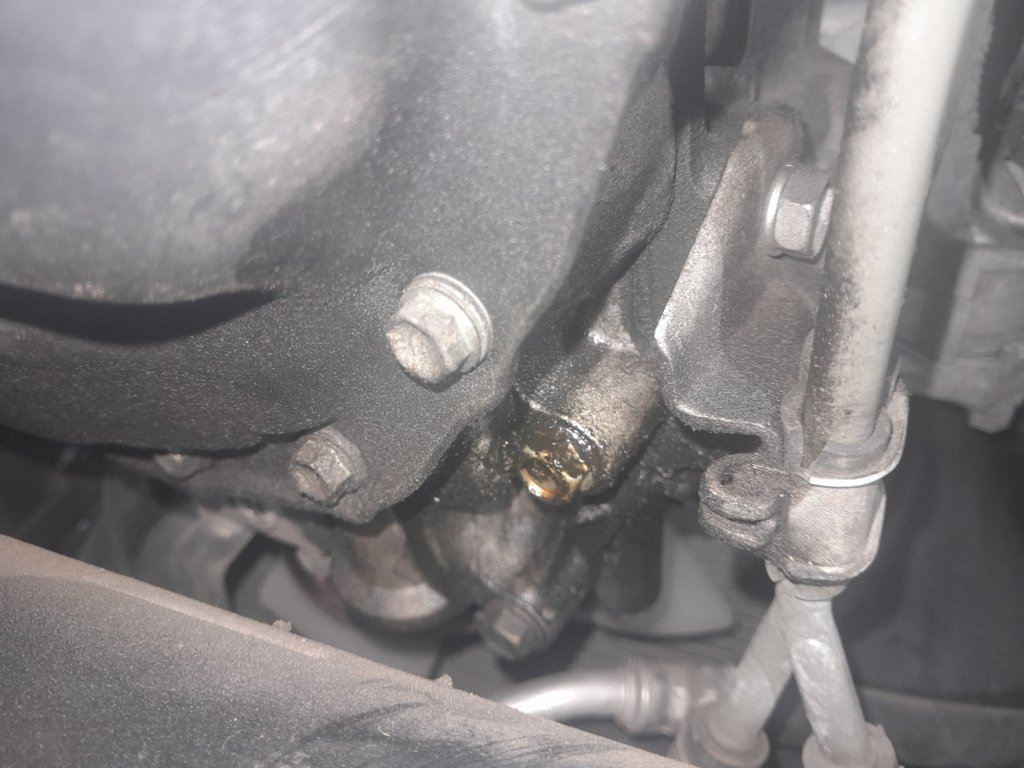

    Need help identifying the leak not sure if it's the upper oil pan or timing gasket

    It's hard to tell from the pics and the small amount of oil. I would clean it as good as you can with soapy water and a rag, then dust with baby powder or similar, and monitor daily until you start to see the seep.
