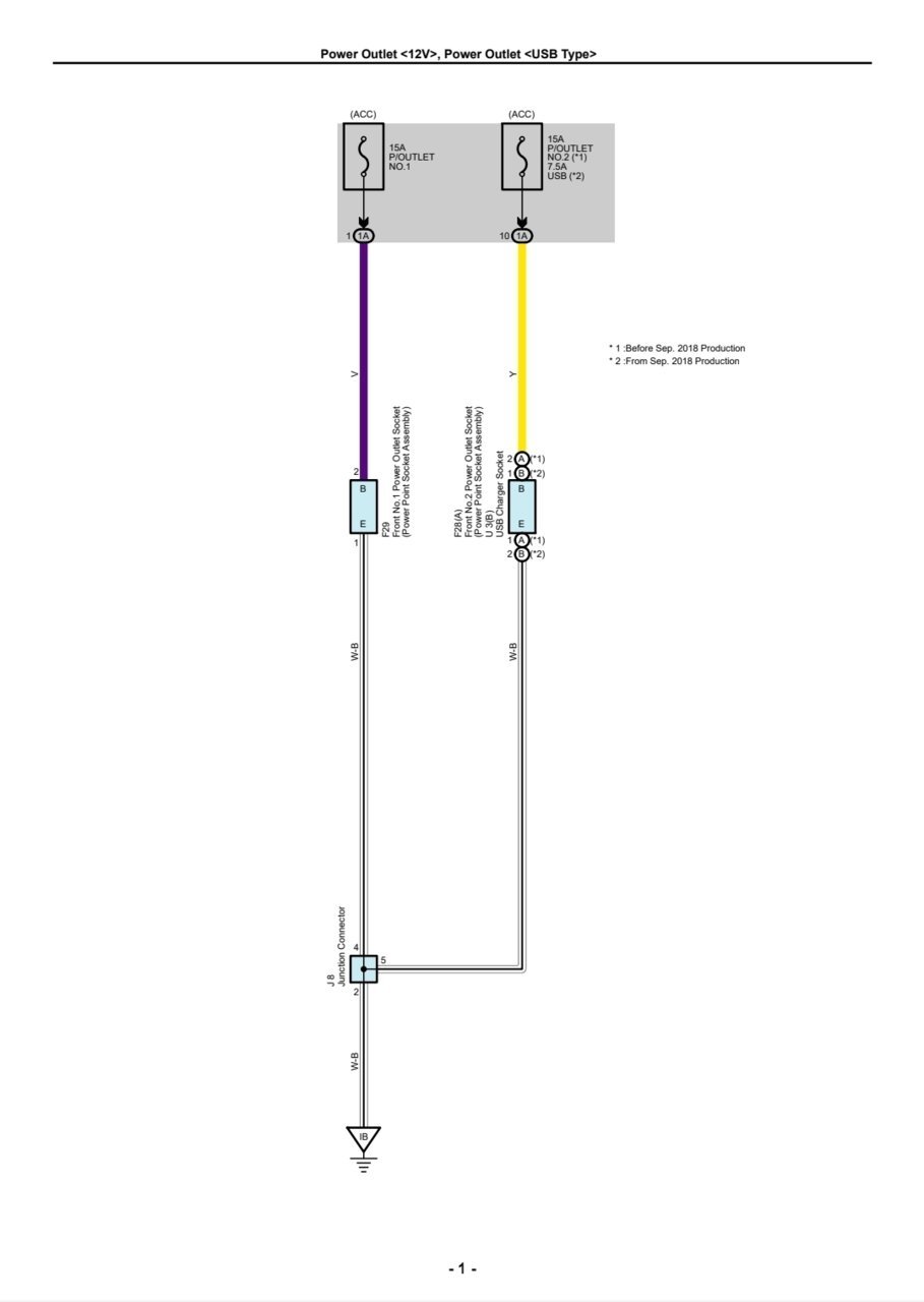

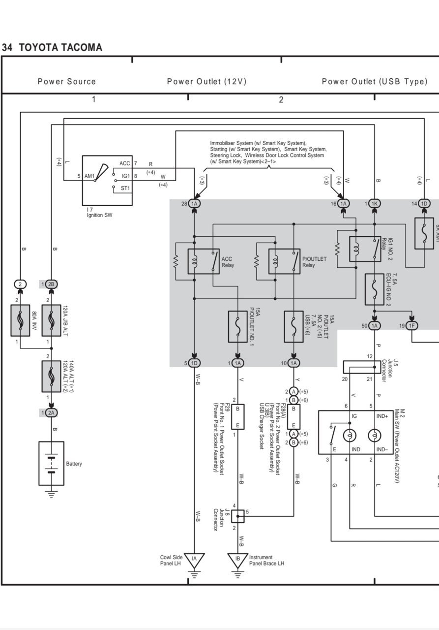

    I know little and am capable of less. But my usb no longer works. I already checked fuses and they are good but the fuse tester did not light up when i tested the power outlet fuse. I thought it might be a relay just not sure which one it is. Cant find a good diagram or info.

    caribe makaira
    caribe makaira Well-Known Member
    Feb 13, 2011
    #51121
    11,811
    Caribbean, Puerto Rico
    05 PreRunner TRD Offroad AutoTrans
    Hood Struts, My version Fogs always ON, Map & Overhead Light Mod,
    Cab Relays are not readably accessible nor removable like in the 2nd Gen.

    TnShooter
    TnShooter The TacomaWorld Stray
    Sep 2, 2010
    #42625
    21,445
    Deogee
    07' TRD Off-Road, Auto
    STOCK
    You’re going to need to check the yellow wire for power.
    Either at 1A or the port itself.

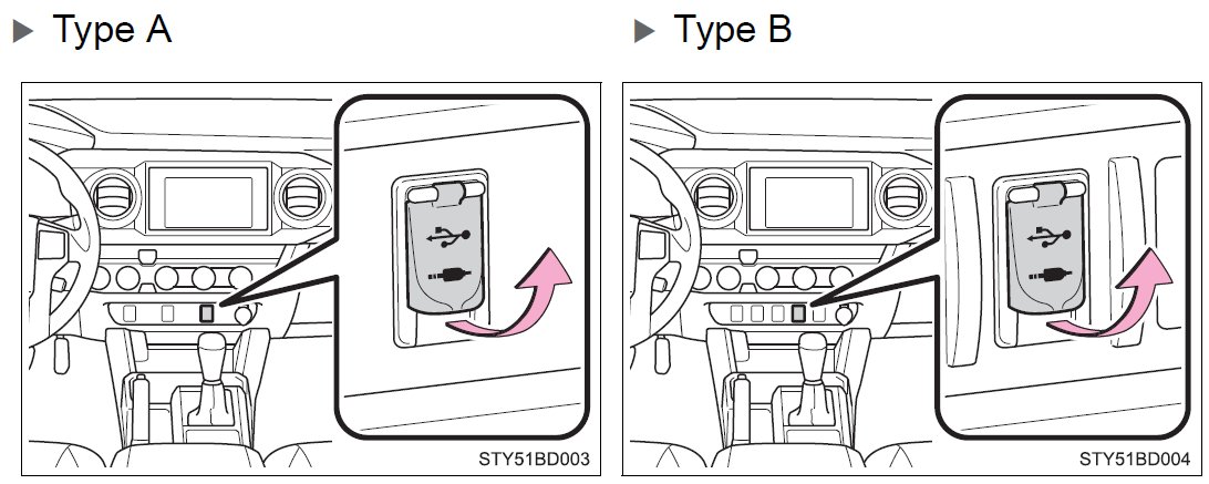

    Feb 13, 2011
    #51121
    11,811
    OP, if this USB port giving a problem, the circuit is handled by the Head Unit (radio)
    The port itself might be the issue and/or the charging cable, even the phone port.

    #160147
    2,848
    Charles
    HA\/\/AII
    07 Shitbox
    Thankfully yes, rough times ahead.
    I know some folks have been reporting back that the usb port is inadequate for phone charging. It's mainly used for media USB drives, software updates etc...
