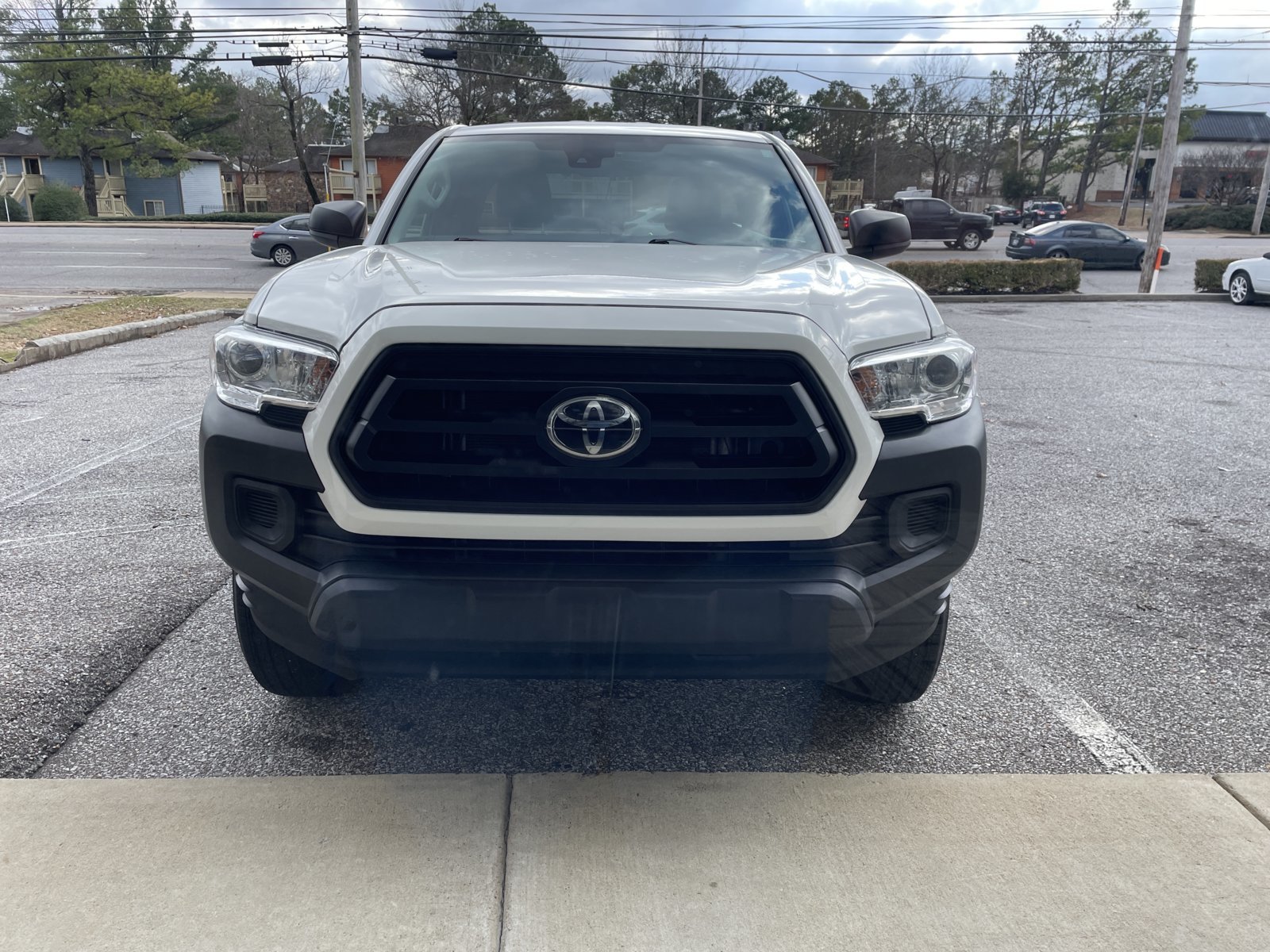

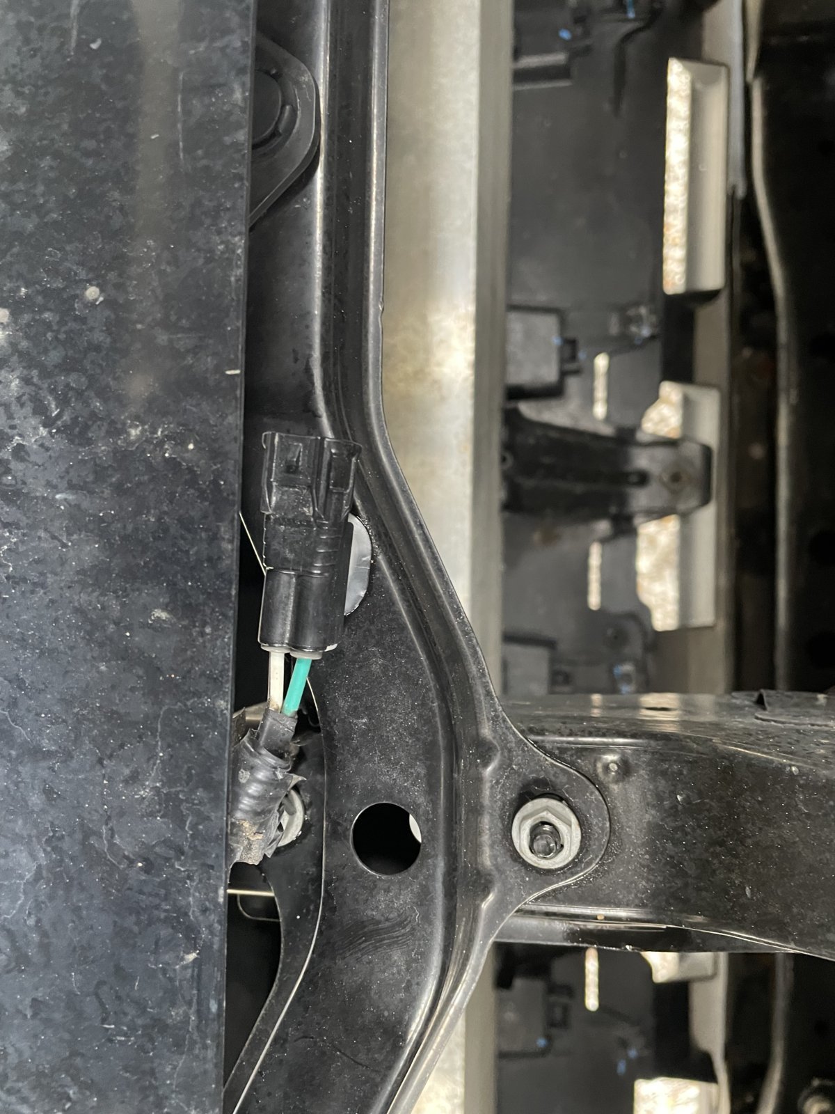

Can anyone tell me why this is not plugged to anything?

    2020 Tacoma access cab 4 cylinder
    None
    It’s literally right under my hood

    I think this is hood courtesy switch connector. If equipped, you will get a Hood Ajar warning on your center didplay

    Thank you!! That makes a lot of sense! I was looking at my pre collision sensor when I noticed that

    Actually disregard. The hood swith has a a violet color wire. Do you have fogs?

    No it’s a very basic model, that’s what I was thinking originally but I’m a new owner so I’m learning!

    Maybe that is where I would plug fogs in?

    Looks like the outside temp sensor.

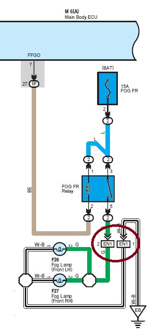

    Yes, this is fogs connector to the right side fog light

    That plug doesn’t look like it was original. See if it’s live or switched and figure out how you can use it. I guess the truck is not new?

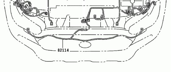

    No...it's to both fogs. Missing harness that mates to it has a Y.

    Yeah, as caribe said. Goes to a jumper harness that connects to each fog. I found that when I installed my grille light bar and followed the harness to see where it went.

    Yep, that's correct. I found Y.
