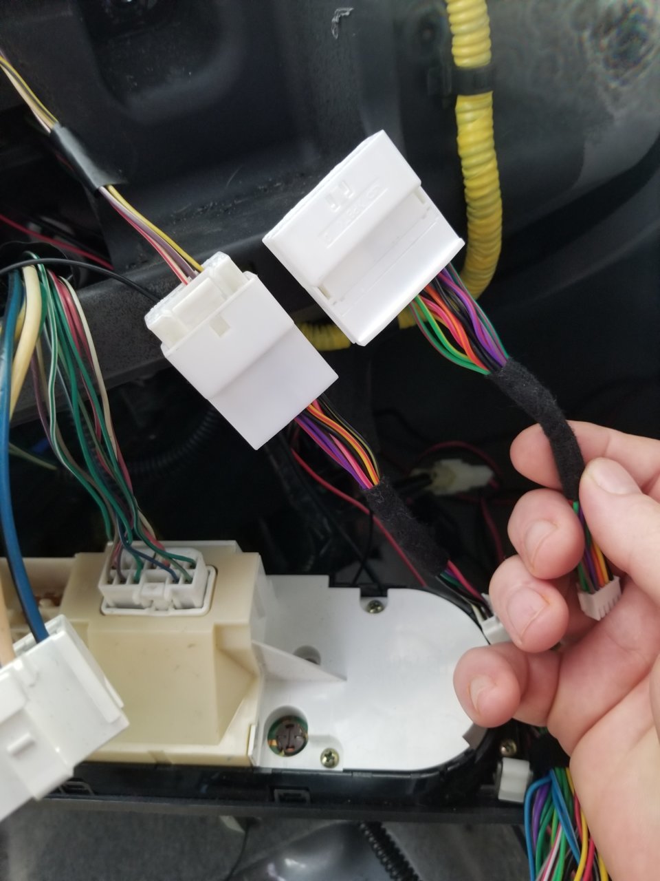

    Your clock spring feeds the S8 black plug in the steering wheel / column area which feeds your R15 28 or 20 pin white plug in back of the radio, RH side. Although most of the rebuild threads concentrate on getting a new clock spring ( good idea, but not sure it is needed) which is expensive. Our older units (through 2013?) have three wires coming off of the clock spring to the 20 (my year) or your 28? pin. Your Maestro TO1 harness has both a 20 and 28 pin adapter... problem is that it doesn't appear to be wired/pinned correctly. Here is a picture of the 20 pin MAESTRO hooked to my 20 pin in back of the radio area. Beside it is the 28pin adapter that would be used for yours.20200116_154525.jpg
