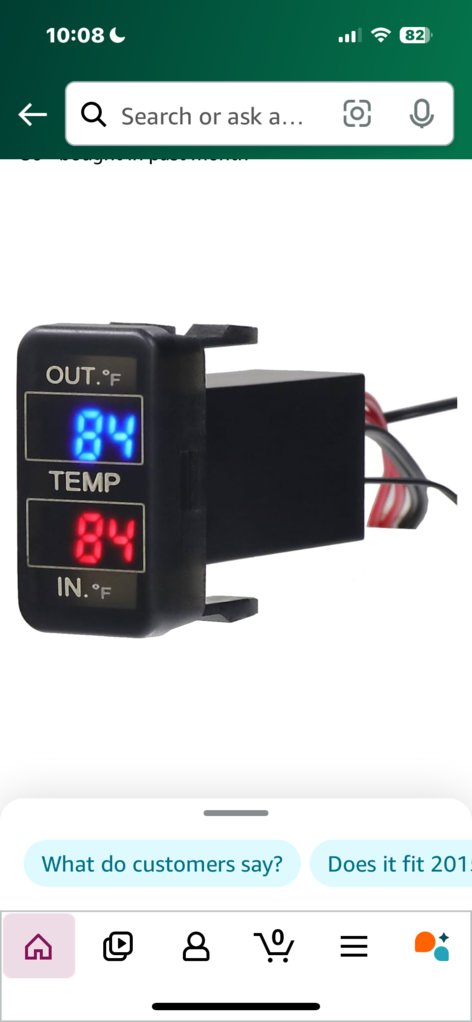

    Can I add the stock bed outlet and temperature gauge to my base taco? Does anyone know if there is a tread or a parts list of what I would need?

    For the temp if you have the sensor on our driver side radiator core support then yes you are pre-wired and it's plug and play. I bought the overhead console from ebay and it was plug and play for my SR5

    Really happy with it for a cheap mod. Iirc it was under $20 last year, this year under $30:rolleyes:
