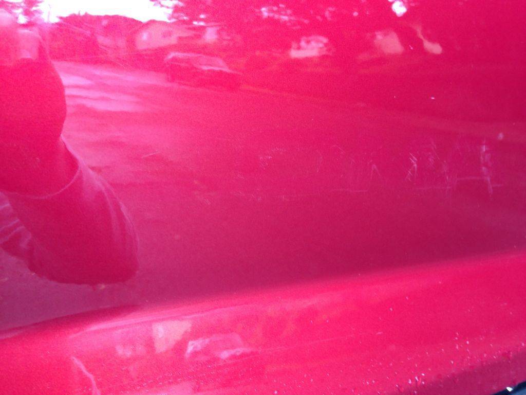

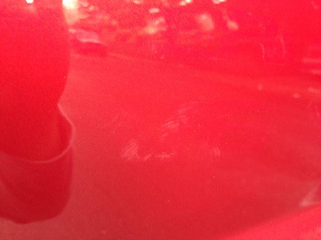

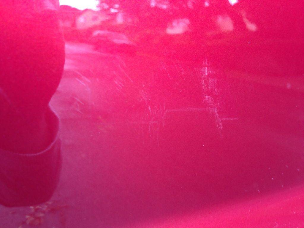

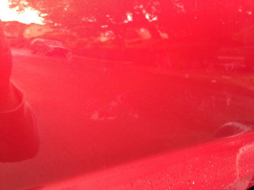

    I let my brother "help" me debadge my truck yesterday. When he finished, everything looked great. But when I looked at the tailgate today, I noticed a bunch of little scratches where the badges used to be, as well a slight outline of the badges. I tried to get the best possible pictures for you guys. The pictures show more of a color separation between the paint and the scratches so it's not quite as bad as the pictures look; but its close. I realized some of the scratches might be through the paint, but it looks as though most of them are not.
    So my question is, can I clean this up with a buffer and/or elbow grease? If so, which products would you recommend I use? I really don't want to have to get my tailgate painted but I realize that might be a possibility. Thanks for any help or suggestions.

    Hard to tell, from the pics, but if the white primer is showing through, too late for buffing, IMO.

    How did he create these scratches? Is that primer showing through?

    It is hard to tell from the pictures... if they're just scuffs in the clear coat, I'd try some rubbing compound with a polisher. I've used Meguiar's Ultimate Compound and a dual action polisher and got some pretty nasty stuff out. If it's too deep you may have to go to wet sanding and polishing. Take it to a pro if that's not in your comfort zone.

    If you can feel the scratches with your fingernail, the clearcoat is compromised. He owes you a new paint job.
    If you can not feel them, it should buff out.
    The "ghosting" from the color fade, OTOH, is there forever. That is in the red under the clear and it won't buff out. Red is a horrible color for fade and I would never debadge a red vehicle older than 6 months or so.
